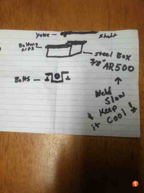

Dang man,
Is there a place to put a shield in there? 4 bolts is better than a tow any day!
Sent from da parking garage of dee detention center
Jim Martin
Arizona
Jim Martin
Dang man,
not really...and the way this thing came UN-glued....even if there was a holding strap to catch the shaft.....it would not of stopped all those flying parts........
