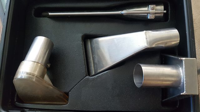

Thats a nice tool set Shorty. Is that the one included with US Products Ultimate machine?

No, the ultimate set is different & I think have Viton " O" rings.
Mine has a crevice tool, curtain tool, & two upholstery tools, all with internal jets.
This is the Ultimate set.
