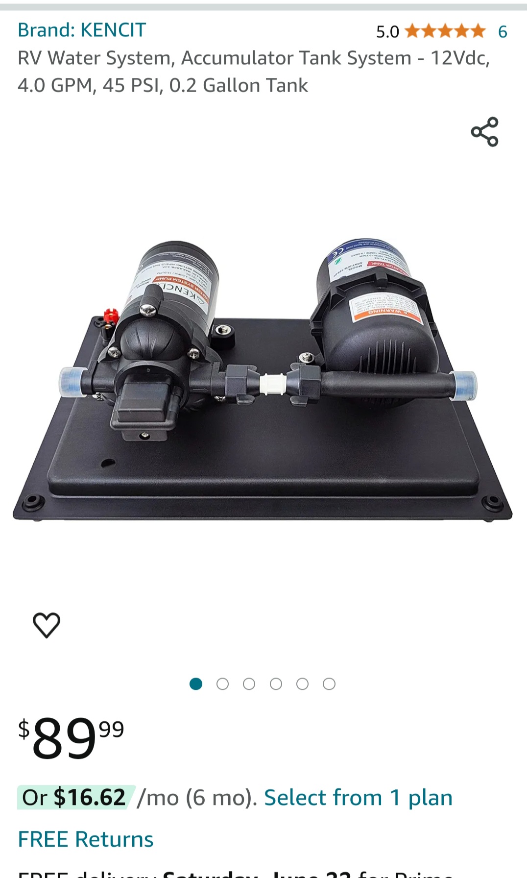

@KevinD recommended this one to me and it has been working great. Right now it sits right next to my machine with no issues.

14,105
I've never understood the need for those bladder tanks. My transfer pump is right next to my 100gallon supply tank and doesn't need that little bladder tank.
Can someone help me understand the difference between the 2 setups?
Reactions: Papa John
I haven't had a bladder tank on most of my setup either. mostly with no issues.
I think your wand technique and use of water also plays a role, as well as the age of the pump. It's important to spend some time OFF the trigger as well.
