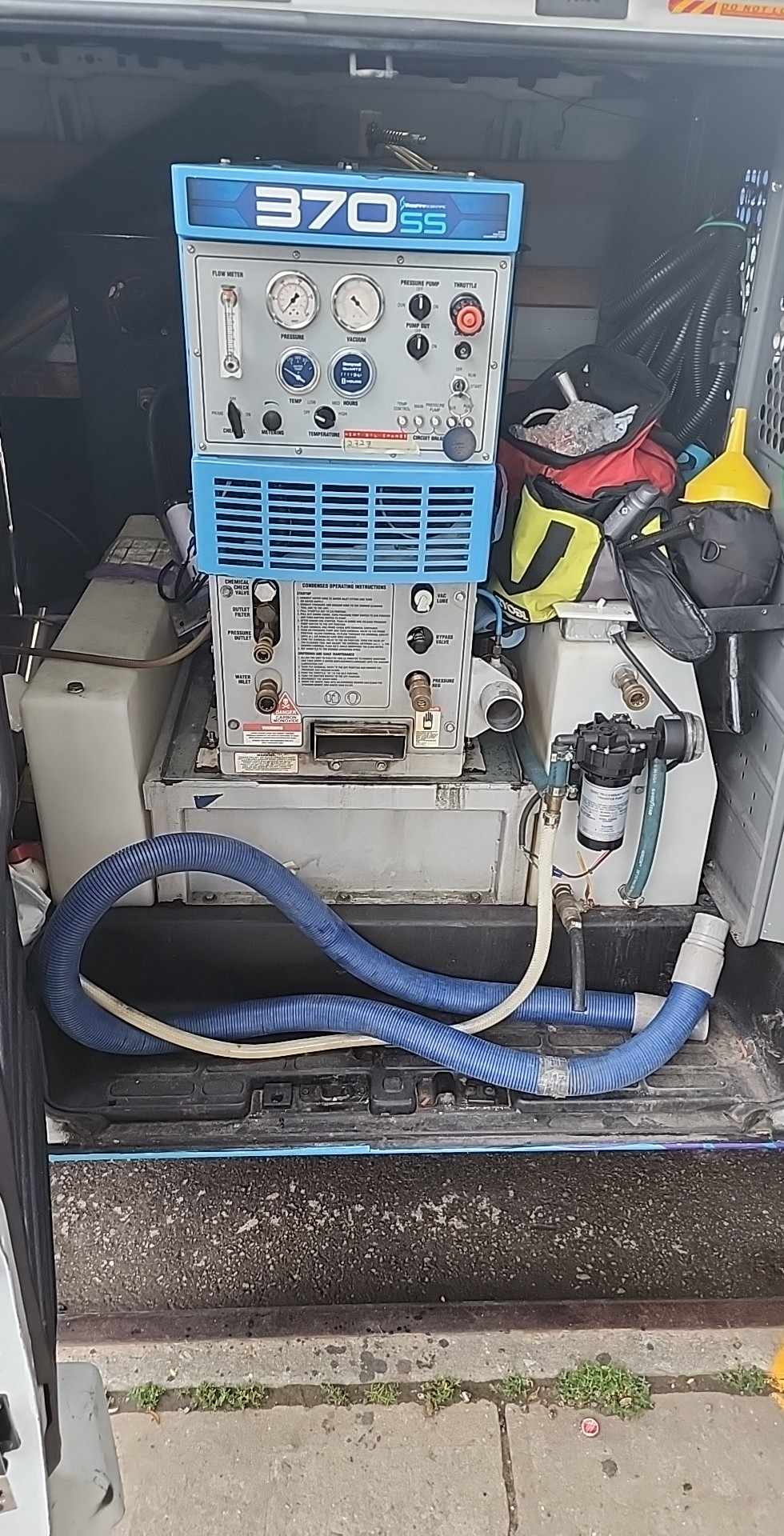

is it the same diameter as the exhaust pipe?
is he using 1.5" wand with 1.5" whip?
if so, I doubt it will make much, if any difference
same for hole gliders

Are you in that area where people have stupid-short driveways where your van is too close all the time?
If so, can you reroute your exhaust to shoot towards the front of your van with a 45-90degree elbow underneath?
I did that in the past with all my other vans-- but down through the van floor and to the rear of the van, I wouldn't want the CO2 shooting towards the cabin area if towards the front. I'm reluctant to do the same with this new van.
It's illegal to park in most driveways in SF if the van blocks the sidewalk, so we park on the street.
I get what you're saying that the blower is already restricted on the intake side by wand etc.
But I wouldn't want it permanently restricted on exhaust side, it would suck (or not) on long hose runs, floods, foam ups when you have to lift the wand to clear the hose
