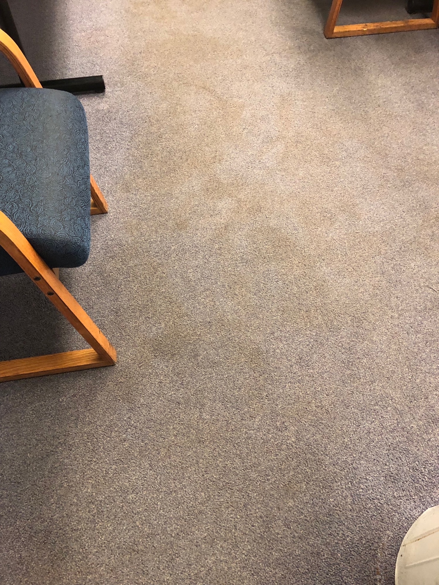

Lemme get this straight, someone put encap chems into solution tank by the gallons?
I think they mixed it kind of! But way too strong. And pumped more then 7 gallons mixed strong onto a medium conference room carpet

The problem wasn’t likely from the Encap. The problem was more likely the Clipper portable extractor. A walk-behind portable extractor on CGD will invariably produce wicking. I would recommend doing a Low Moisture Encap, perhaps using bonnets, with a good hydrogen peroxide Encap product like Encap-HydrOx. That should resolve the discoloration problem for you.
I’ve been complaining about using such small portable on CGD for 2 years now.

so you are recommending using an encap to solve an encap problem. Where does it end?????
jk
Yes indeed. Proper encap can solve their problem. 👍
I very seriously doubt that it's actually an "encap problem". They used a walk-behind extractor to perform "encap". ??? So they didn't clean with a straight encap method. Instead, they cleaned a CGD carpet with a low-performance extractor. And she said that the carpet was "over-wetted". So poorly executed HWE would seem to be the culprit for the discoloration. And we don't know what "encap" product was used in their extractor, or how (or if) it was measured.
Now if they were to re-clean the affected carpet with "Low Moisture Encap, perhaps using bonnets, with a good hydrogen peroxide Encap product like Encap-HydrOx" - they could successfully correct the discoloration caused by wicking. A properly implemented, true encap cleaning, will normally correct common CGD problems - like the one they've described here. And Encap-HydrOx is an ideal choice for discoloration, browning, etc - due to its strong hydrogen peroxide formulation and extreme acid-base.
