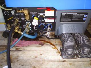

CleanEvolve said:
Thanks guys,
What type of grease should i be using with the grease gun?
I've always used hi-temp wheel bearing grease
pump it in til it squishes out the vent hole on the bottom of blower bearing housing .
don't freak when the first time you run the unit you see a pile of grease under the blower.
It's normal
when changing fluids, engine oil, blower oil, etc, change fluids on a warmed up unit, they flow better, faster and more complete .
Regarding the belt tension, how tight should they be?
about 1/2" to 1" flex when you push down "somewhat" hard on it
too tight and you can cook bearings
not tight enough and it'll slip and glaze belts under load.
