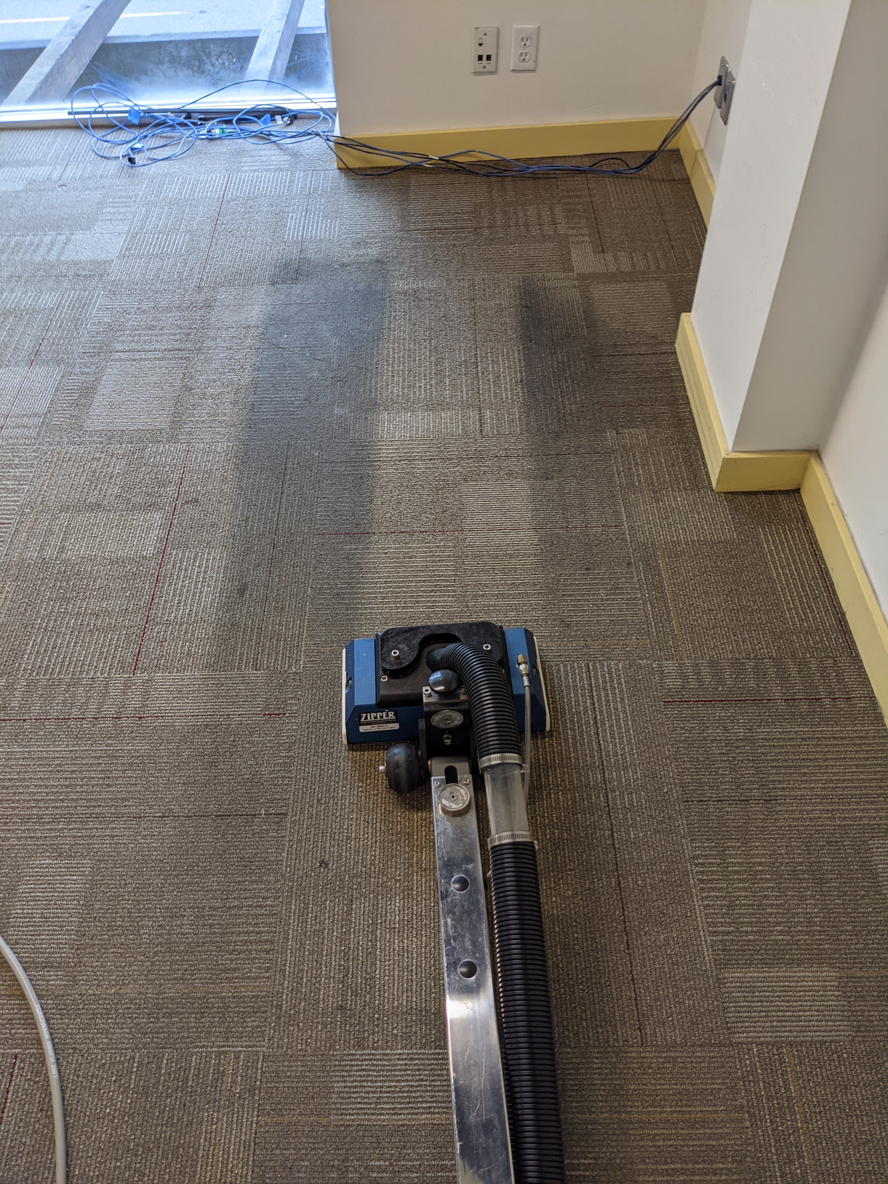

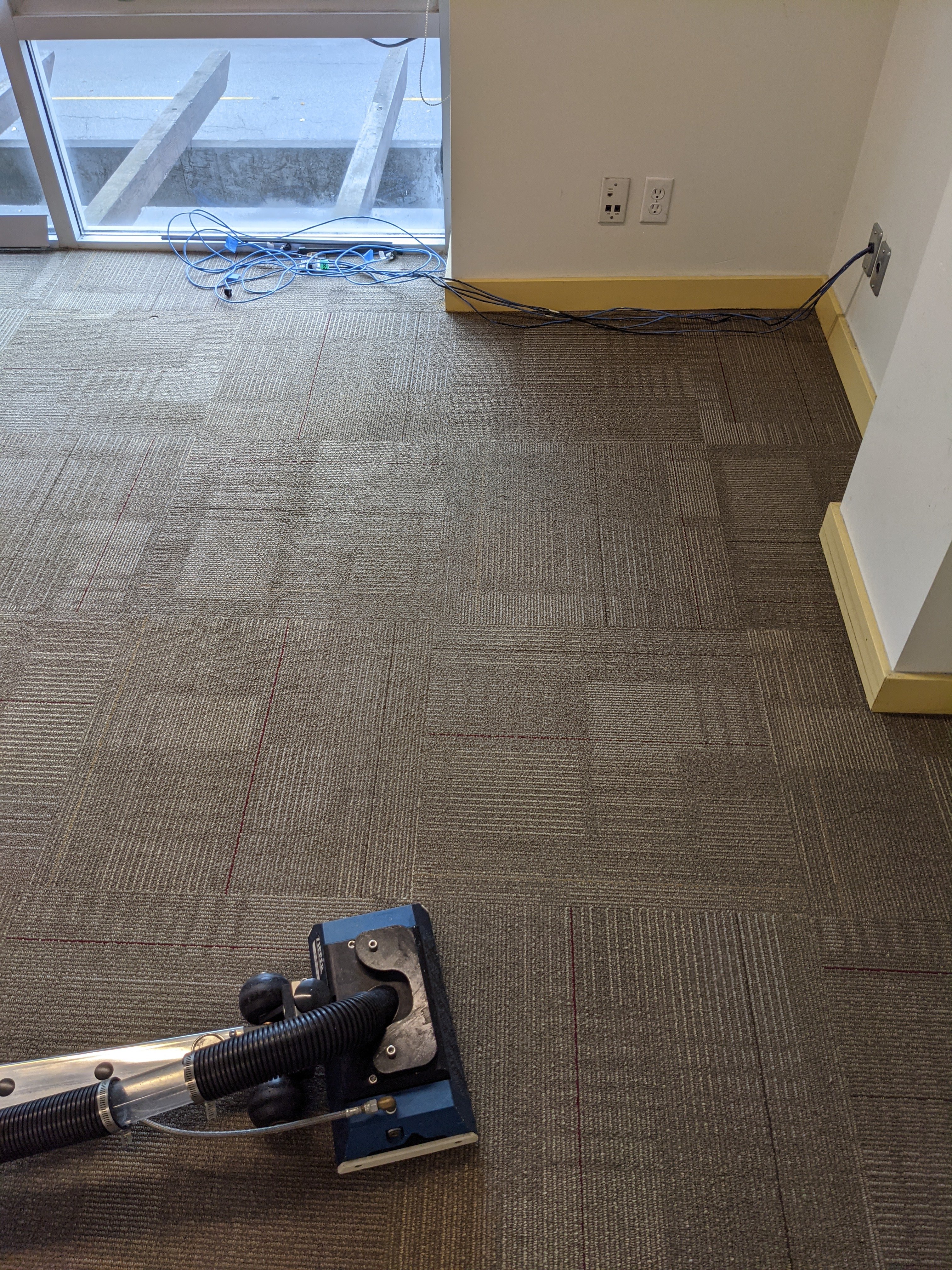

Just Zipping through this 1000 sqft office. Prevacuum, prespray with Saigers Code Red and nothing stands in our way.

Is that the spinny-type? Been thinking about getting one.
28,271
I don’t find it any easier on my back
But it sure cleans better
Once you get the hang of working away from your hose, you can keep both hands on and push/pull evenly. Has to be at the right height to move without locking down yet extract efficiently. Usually adjust it so that you can just slip a business card under the rear glide

I clean my way in. Hoses aren’t an issue. Height adjustment isn’t rocket science.
It’s no easier on the back.

Is the Zipper kinda unwieldy / impractical in tight spaces? Like furnished residential?

I find it unwieldy in residential. I like it in more wide open commercial. I have seen guys use it in residential but I find it would slow me down. Would definitely flush well though.

i agree, its not easier on the back, but its not harder on it either. BUT it IS much easier on the arms.
It's easier on my back. If I had to use a wand on this job, it would have taken me longer and I would have had to work much harder.
