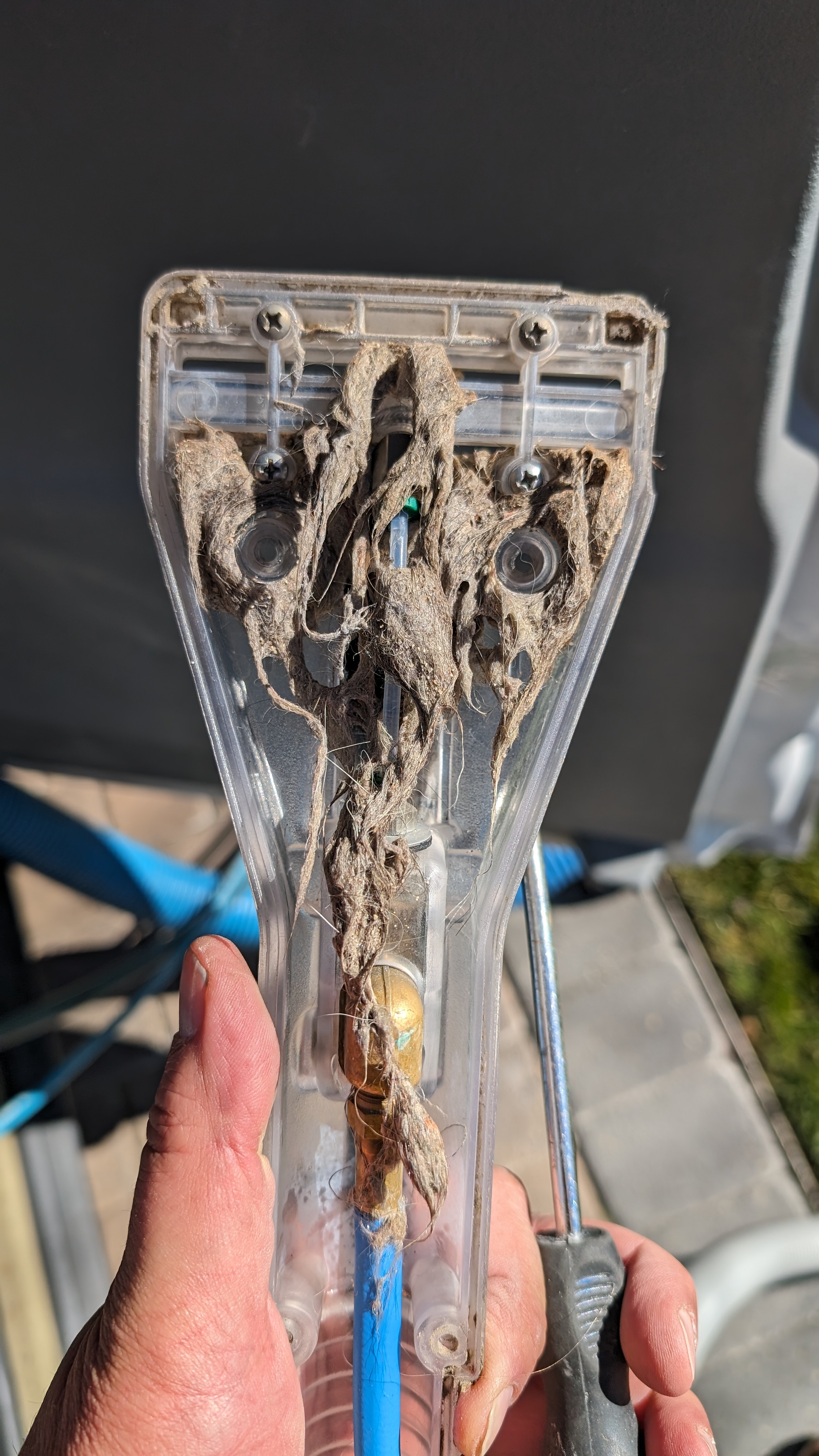

Thinking of Boyle today.

Why let it get it that bad?
As soon as I see the first ‘black noodle’, I take it apart, clean the gunk, wash the tool in its entirety, and oil the valve…
I’ve never let it get that bad.
The tool doesn’t like to be clogged.
AND, IMHO, the stock hose, and solution line is junk.
Get rid of that Shyte, get 18-20’ of stainless steel braid, and do away with the subpar hose that comes with it, and replace with matching length of quality 1.5…
THEN it becomes a great UPH tool…

The OEM hose is steel braided it just happens to be covered in blue rubber which may have fooled you.
And I don't know about you but sometimes we clean giant sectionals that are nothing but multi dog beds thus the encased boyled beaver

I just upgraded to the clear handle design and I love it.
I think the wider vac slot improved the performance too.
