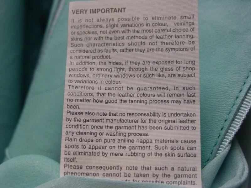

Roger Koh said:I have refinished a $3500 Zegna® jacket just with Poly-Brush® (And it just smells like brand new Money, so true!).
