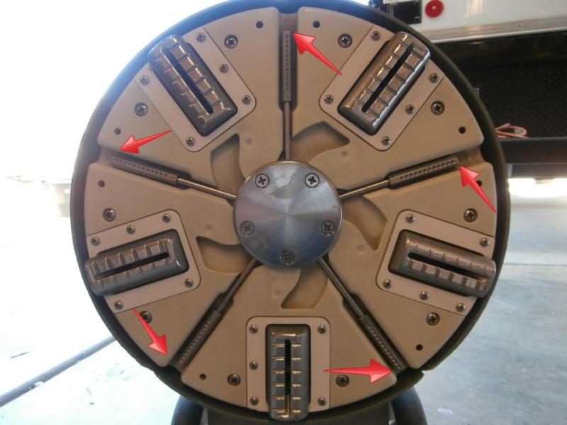

My 1st generation HOSS has been fudged with to increase flow by increasing the "Flow Disc" hole size. I would assume it puts out more than the XL (even though I have not installed the full set of long spray bars yet,I'll do it Sunday) So I'm a bit surprise at how much quicker it recovers the watert than the XL does.
What with the new black shaped glides that we feel clean deeper and faster the two machines are near identical in effect and control except the HOSS needs far less dry passes.

Hoss has five vs four glides on the RV. Might 'splain better drying with bigger suck machines.

I believe it is called a high flow kit.....comes with the staggered long bars and a needle valve....

Shit, I guess ill be selling the XL I just bought, because my modded Hoss was the slloooooowwwwwest RE I had EVER used...

Jim and I were wondering if the RV shoes need channels or holes to increase airflow and break the seal..
Somebody should bring a Makita and a grinding wheel to Vegas..

My Hoss was totally Jim Martin pimped, no flow disk, all long jets, Parker flow control valve... You had to move at a SNAILS pace to keep it from streaking.

Actually i thought about ordering another set of shoes, welding them closed, then drill 3/32 holes and some air channels into them... ala-chemdry rx shoes

Had to be operator error....5 high flow bars...off set leading edge vacuum shoes...it is physically impossible not to go faster....
you are pushing 4 spray jets that have to fan out and vac shoes that plant themselves down into the carpet.........with no vac relief.......

Equal only on your vortex. ..your comparing spray jets againest flow bars....and vacuum shoes that allow the air to move against ones that plant themselves. ..kinda like a glided vs a unguided wand....
Hoss is going to give you a better flush and dryer carpet....
