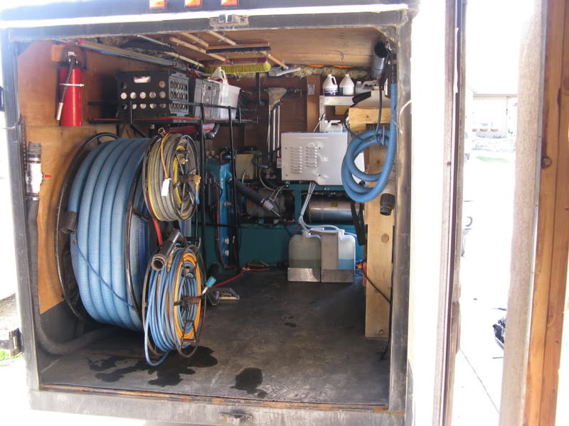

the problem with mounting a machine facing out the back door, is it can in some cases make the trailer unstable to pull, you want more weight of the trailer on the tongue to a point, also with the machine facing out the back you essentially loose the space on either side of the machine, also the back of the unit is not uniform in shape so there is wasted space there. I still have room to wheel in dehus and fans, a dehu will fit under the rack ahead of the reels, if I stack things carefully 2 phoenix 200's and 20 air movers will fit in there comfortably, if I was to do it over again, I would have gotten the skinny reel that only holds 200 ft of vac hose, and I would have even more space at the back door, I also want to get a v nose model trailer so I can mount the solution jugs and demand pump in front of the truckmount thus gaining even more room.

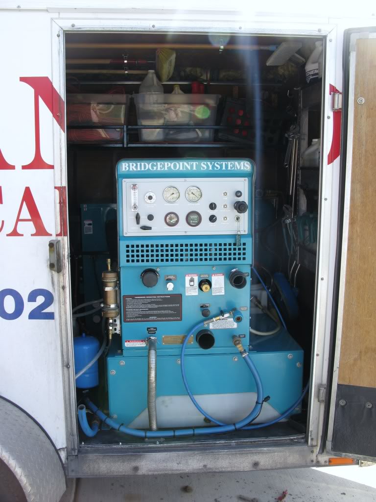

It almost looks like my set up, not done with mine yet though. What size is that bridgepoint

Only thing I don't like about the hose coming out the back is it usually isn't facing the home (so you don't have to pull around a corner) and the TM exhaust is.
I get the weight issue but I would think a TM of that size could be put right over the axle near the back so all that would be happening away from the home (including noise) and if you had to work on it on the job, they wouldn't be able to see what you are doing from their living room window.
Plus, older machines don't look great but a hose real can look good from the side it you clean it up and have nice hoses.

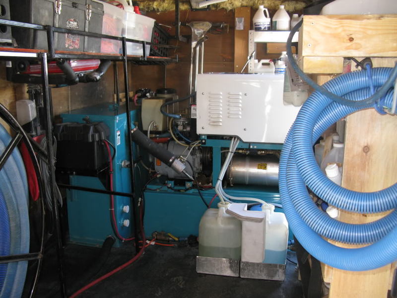

the kung-fu vacuum holder is the highlight.
ps: why do you have your coolcuffs set up backwards on your wand? a swivel 2" male would be sweet on the lead hose and just slip over your quad jet pipe, it's nice having the swiv. male.
edit: on the Noise thing, it's a Prochem not a White Magic.....lol
the hoses pull out the back just fine, I spool out at least 50 ft of solution hose in my hand and carry that into the house, the vac will just pull off the reel, I try to pull slightly ahead of where of where the door is. this machine with catalytic HX runs very very clean, no issues with fumes, with a full water tank and waste tank the machine is going to be about 1600#'s that is alot of weight to be mounted rear of the axles, This machine is an older machine its over 7 yrs old however its been taken care of and actually cleaned every now and then, a customer seeing it with the side door open should have a favorable impression, however the trailer is getting ratty looking I really need to replace it pretty soon. my point is to show IMO what is a much better use of space,
greenie thanks for the sanitaire holder complement, it used to bounce around on that rack I made welded angle iron with pipe insulation on it keep it from scratching the unit, it stays put and out of the way now.
I like the padded vac holder also, great idea!
Keeps the head from getting used as a step stool.

anypne know what the little brass tank on the left of the machine is for, for extra credit

Is it a pipe bomb or just one of those homemade pulsation dampners.

nice call is this a common way to get the wd-40 to the blower becasue i have neve seen that before.

Tidy set-up but if there is not a door on both sides wouldn't you have to be a contortionist to work on it. :?:

greenie guessed it, a flick of the ball valve lubes the blower
