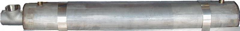

Switching from propane to heat exchanger.
Anybody dumped their propane heat (little giant 2ht/3ht) and went with a heat exchanger from Cobb or John's Custom Machine?
Heat drop/increase?
larger image
WLD55 - Stainless Steel Heat Exchanger
$899.00
SS Heat Exch 5.6" x 42" All Stainless Steel Heat Exchanger
Hi-Pressure Design 1500 PSI for Grout Cln
2" Exhaust Port; 2" Tee for Inlet; 3/8" FPT Water Ports
Size 46" x 6", Replaces #3 Little Giant w/higher heat (20 HP)
19 Tubes for High Efficiency
Blower & Engine Exhaust requires no bypass.
