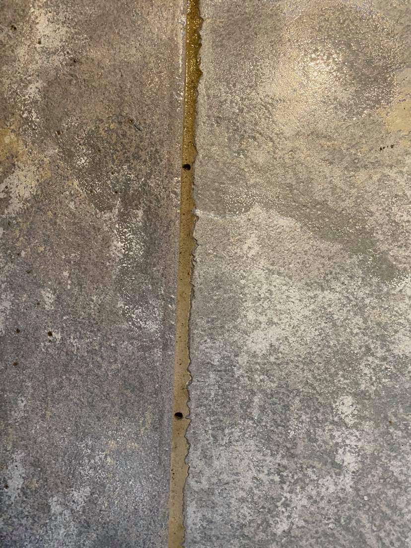

Subfloor drying efforts?
117,326
Every grout line throughout an entire kitchen...

Im asking if that's what the cause or source of the holes are°°°°°
28,275
Could have been using an injectidry system to dry the subfloor if they had a flood.
What is the distance between holes? They could have used the holes for their moisture meter electrode probes when checking the subflooring.???
Possibly fixing hollow tiles. We do that but always grout in the holes
did they have termite issues? I’ve seen that before too
Upon initial inspection I would’ve used thermal and had the tile pulled. It’ll delaminate with that amount of moisture.

this isnt my project, rather a hard Surface Course student's
if it were a too wet grout install issue I would expect other signs, which there isnt.
That’s why I’m pretty sure they had an issue with hollow tiles or termites. Termites is usually perimeter treatment but I have seen mid floor treatment.
hollow tile we drill holes into grout then inject adhesives then grout our pilot holes.
117,326
She said there is a wood framed/sided island in the kitchen that shows signs of water damage.
