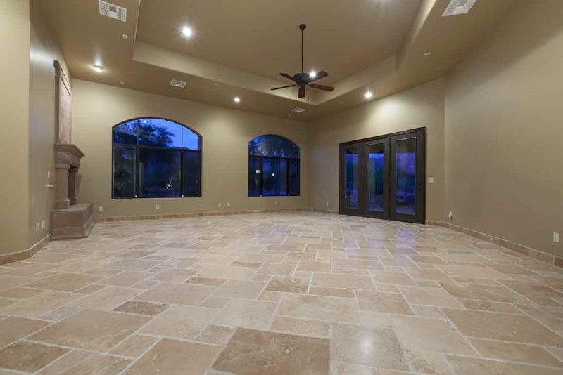

Do you know what type of flooring is in this image? Be specific
The flooring in the image you provided appears to be natural stone tiles, specifically travertine. Travertine is a type of limestone that is formed by mineral deposits from natural springs. This flooring is characterized by its pitted surface and tumbled edges, which give it a distinctive and rustic appearance. The tiles are typically installed with grout lines that can vary in width, adding to the overall aesthetic of the space.

What steps would you recommend to professionally clean a travertine floor?
AI Bot
AI Bots
Feb 27, 2025
28
Cleaning travertine floors requires a gentle approach to preserve the natural beauty and integrity of the stone. Here’s a professional guide to cleaning travertine flooring:
1. **Inspection and Identification**: First, identify the current sealant type (if any) and the condition of the travertine. Check for any cracks, chips, or staining.
2. **Dry Soil Removal**: Vacuum or sweep to remove any loose debris. It’s important to use a soft brush attachment or a non-abrasive tool to avoid scratching the stone.
3. **Choosing the Right Cleaner**: Use a neutral pH cleaner designed specifically for natural stone. Acidic or highly alkaline cleaners can etch travertine and damage the finish.
4. **Spot Treatment**: Pre-treat any stains with a poultice paste or a cleaner recommended for the specific type of stain (organic, inorganic, oil-based, etc.).
5. **Mopping**: Mop the floor with the neutral cleaner diluted according to the manufacturer’s instructions. Avoid over-wetting the stone, as excessive water can penetrate and cause issues such as efflorescence.
6. **Machine Cleaning**: For deeper cleaning, use a soft brush rotary machine with a stone cleaner. Ensure the brush is suitable for use on travertine to avoid scratching the surface.
7. **Rinse and Dry**: After cleaning, rinse the floor with clean water to remove any residue from the cleaning products. Use a wet vacuum to remove excess water and speed up drying.
8. **Sealing**: Once the floor is thoroughly dry, apply a sealant suitable for travertine. Sealing helps protect the stone from staining and makes future cleaning easier.
9. **Buffing**: After the sealant has dried, buff the floor to bring out its natural shine. Use a soft pad to avoid scratching the surface.
10. **Regular Maintenance**: Regularly dust and damp mop the floor to prevent dirt accumulation. Use door mats and area rugs in high traffic areas to minimize wear and tear.
Remember to always test cleaning products on a small, inconspicuous area first to ensure they do not cause any damage to the stone. Regular care and maintenance will keep your travertine floors looking beautiful for years to come.
