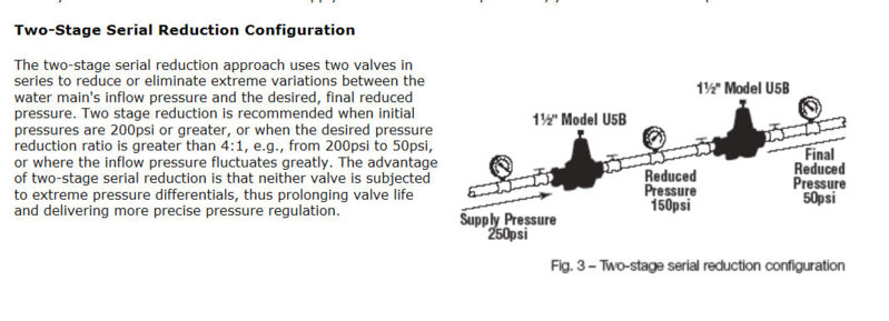

Not really a design flaw, I think, but a limitation of any pressure regulator. The regulator has a "turndown" ratio - this means for any given outlet pressure the reg works over a certain range of inlet pressures. Where the inlet pressure varies wildly the reg will not be able to maintain the set pressure without constantly re-adjusting the screw. So, if the reg was set to provide 14 psi at the distributor's shop (80 psi in), then it won't be right when the inlet pressure falls to 28 psi.
This is a recognized limitation in the water industry. For these applications they recommend a two-stage setup (see the pic).
For your situation you could add a pre-regulator for when the inlet pressure was high (normal), and remove it for those very-low pressure situations. This would allow you to keep the primary regulator at a fixed setting.

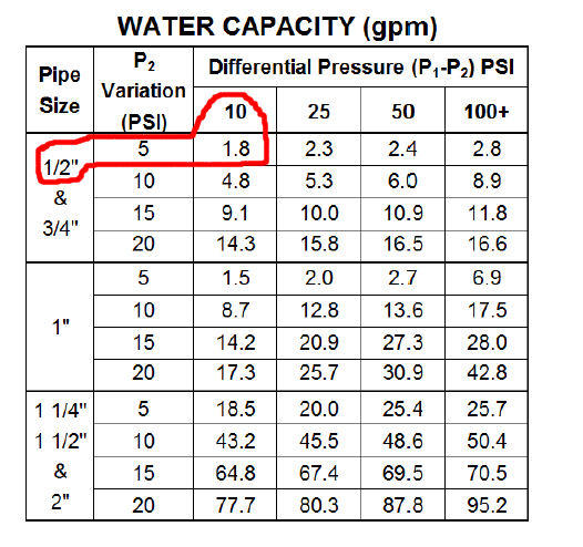

I have attached the datasheet for your reg. At a differential pressure of 10 psi (like 25 in, 15 out), your reg has a capacity of only 1.8 gpm, and that's at a pressure reduction of 5 psi (the 15 psi out will drop to 10 when flowing 1.8 gpm). So at the very low well-water pressures you are operating very close to the limit.
So, setting the reg to work properly at that low pressure, then adding the pre-regulator when the inlet pressures are normal is a good solution (in my mind at least).
