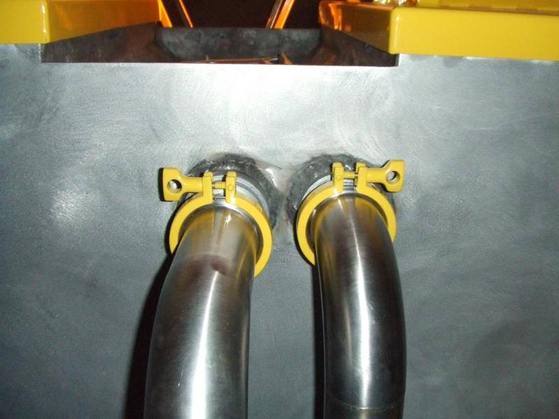

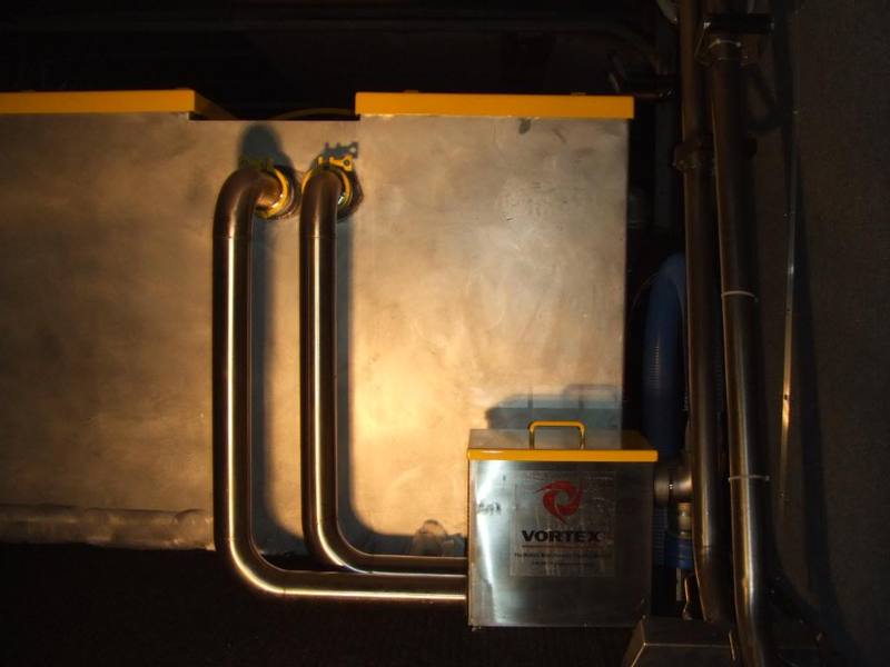

Sorry I did'nt explian, but I am running dual 3" stainless pipe from my tank to my stainless filter box and then out runs dual 2.5" hose. I run 200' of 2.5" and 50' of 2".
Now that I have my TI's with a glide pakage on the way from john, I will try running 2.5" to the wand. My 2.5" is very flexible and grows on you very quickly. By now i have done several jobs with it and the 2" looks like toy hose I used to use. Very impressed and can't wait to finish my mods so I can dual wand!

here is a pic. of the filter box plumbed into the waste tank.

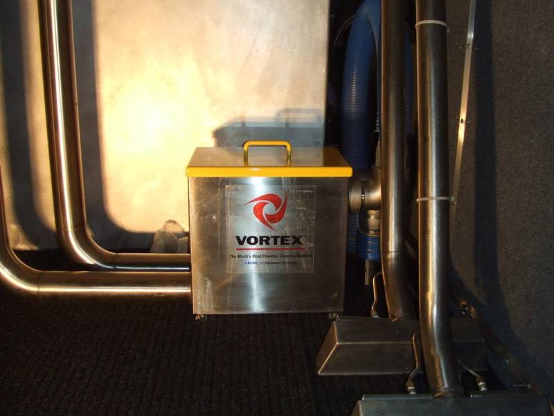

the filter box.
The QD to waste tank.
