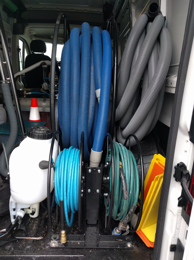

I recently purchased reels from Reel Innovations. They are a bit on the high side, but they are very nice reels. Mine is an electric vac reel and two solution reels mounted on the floor in front of the vac reel.

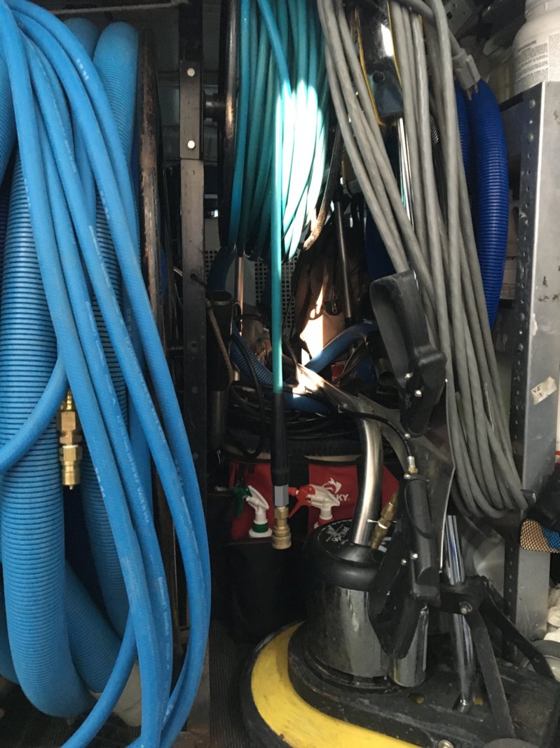

Can you post a photo as well?
If you mean a picture of the current set up, here it is. Headed to a job with carpet and tile & grout. Back to front, is the 175; carry-in bag with spotters, slides, towels, etc.; and BrushPro with SX-12 and SX-7. You can see how the solution reel gets in the way.

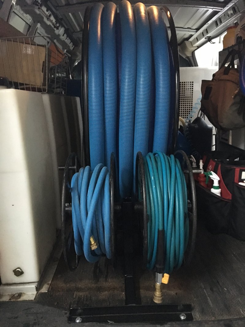

I ended up getting the Rokan dual hose stand. I already had the two storage reels so it made the most sense. Reeling in the vac hose hasn't been an issue and the added room for the floor machines is great.
