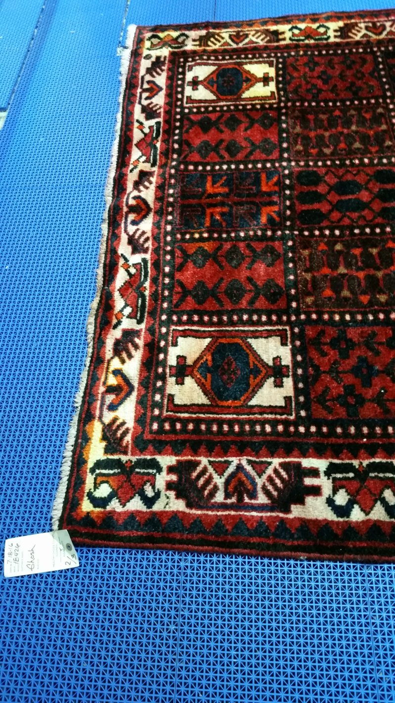

I have 3 rugs in my plant that had severe urine stains on them.. the urine was so old the rugs smelled like ammonia. We cleaned on the acid side and w cold water but the colors still bleed ALOT and over the entire rug.
Use Red 1 and Magic but still not good enough.
We warned the custy before hand that this might happen and our told them we take no responsibility if they have us clean them..
How do you think we should handle this?
27,862
There might not be anything more you can reasonably do. The carpets were damaged before you got them. Before I use an acid cleaner, I usually treat a bleeder with a non detergent acid product, like a browning treatment (acetic acid). I find this helps to fix the dyes somewhat and then I clean with the detergent. Works for me

The red dye run is worst in person. the yellow of the white areas is where I used Magic. The white rug is the back of the rug cuz the dye run shows up better.1470348807902.jpg

I might have to send my tech to the rug summit with the rugs for retraining and trying to solve this problem.. On the white rug-- since stain 1 and red 1 wasn't removing the dye-- he used a mixture of vinegar and dish soap-- because that's what the internet said to do :hopeless::oldrolleyes:
