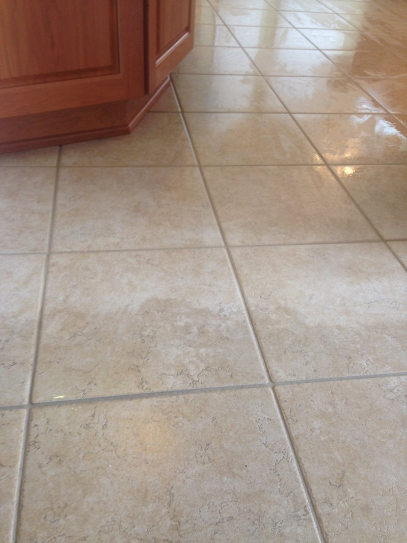

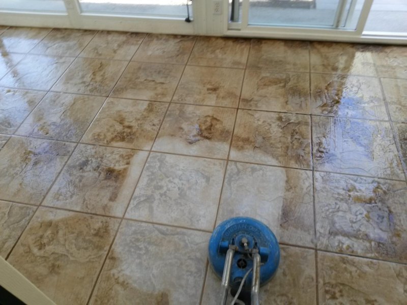

I got this stuff 2790 from Dave at sales@cleanprosupply.com to try out and I cant believe how amazing this stuff works.
This lady had what I thought was dark pink ceramic tile and some pretty rough shape grout. 20 years old never had a professional cleaning. I was dreading the cleaning afraid of choppy uneven results.
I applied this 2790 at 10 oz to the gallon down with a deck brush. I noticed the floor was getting muddy as I was scrubbing it. Im like what is this. The minute I went over it with the spinner, I couldnt believe my eyes. I didnt realize how dirty the tile was and the grout literally looked brand new. I could even have done with out the grout tool which I always use and over use. I was so amazed at the results.
You guys have got to try this stuff out. Heres a before n after pic.

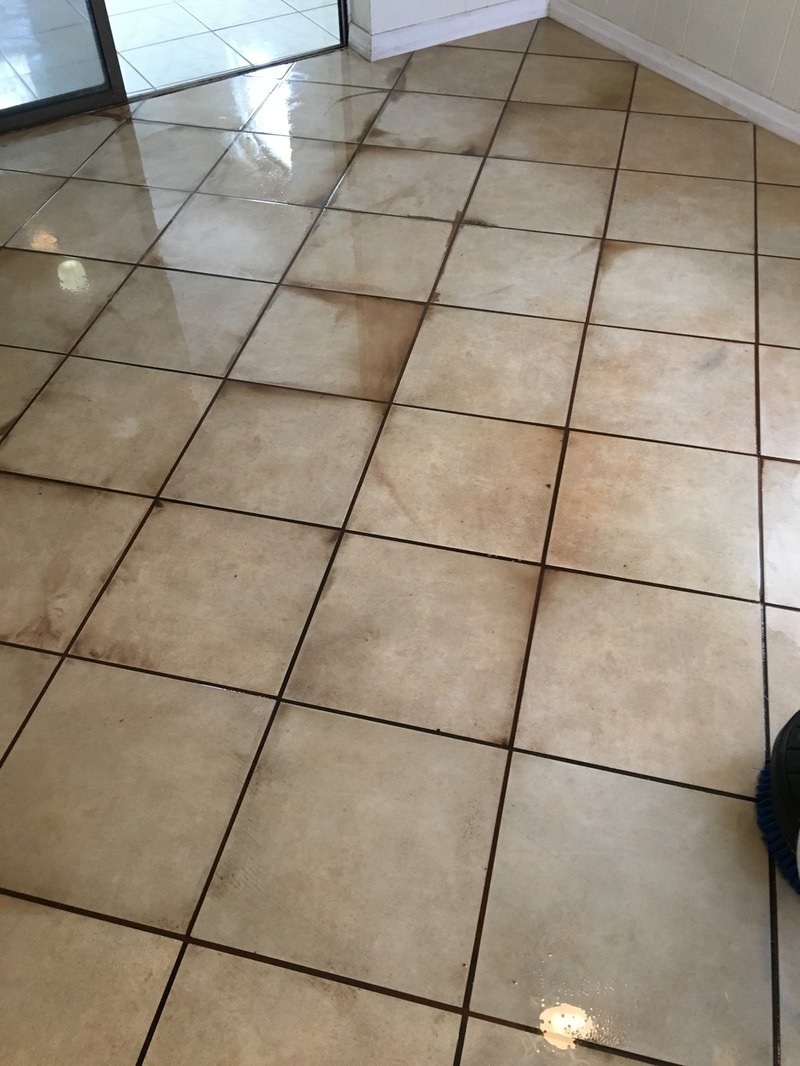

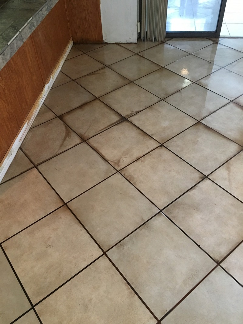

Here's another filthy porous ceramic tile job cleaned with 2790. A sunroom where 3 large dogs slept.
