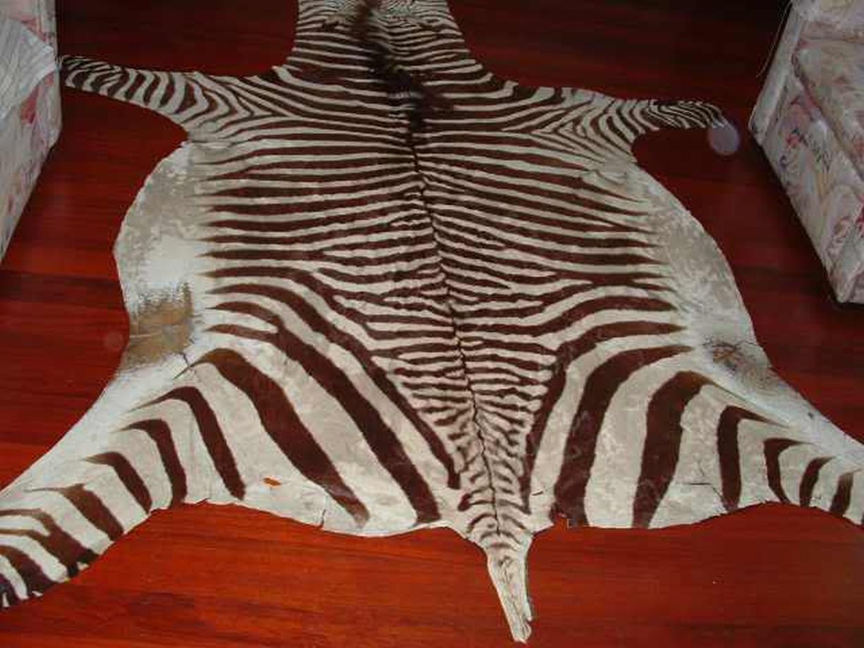

Tom, how would you go about cleaning this.
It had several fabric patches sewn onto the rear where it had parted. 🤔
I restored this one probably 15 years ago.
Thanks.
:yoda: :very_drunk:
Thanks.
:yoda: :very_drunk:
I got asked to do 2 like that from a taxidermist while I was doing his carpet
the seam/repair underneth had left a green stain on the carpet, I declined cleaning the skins
