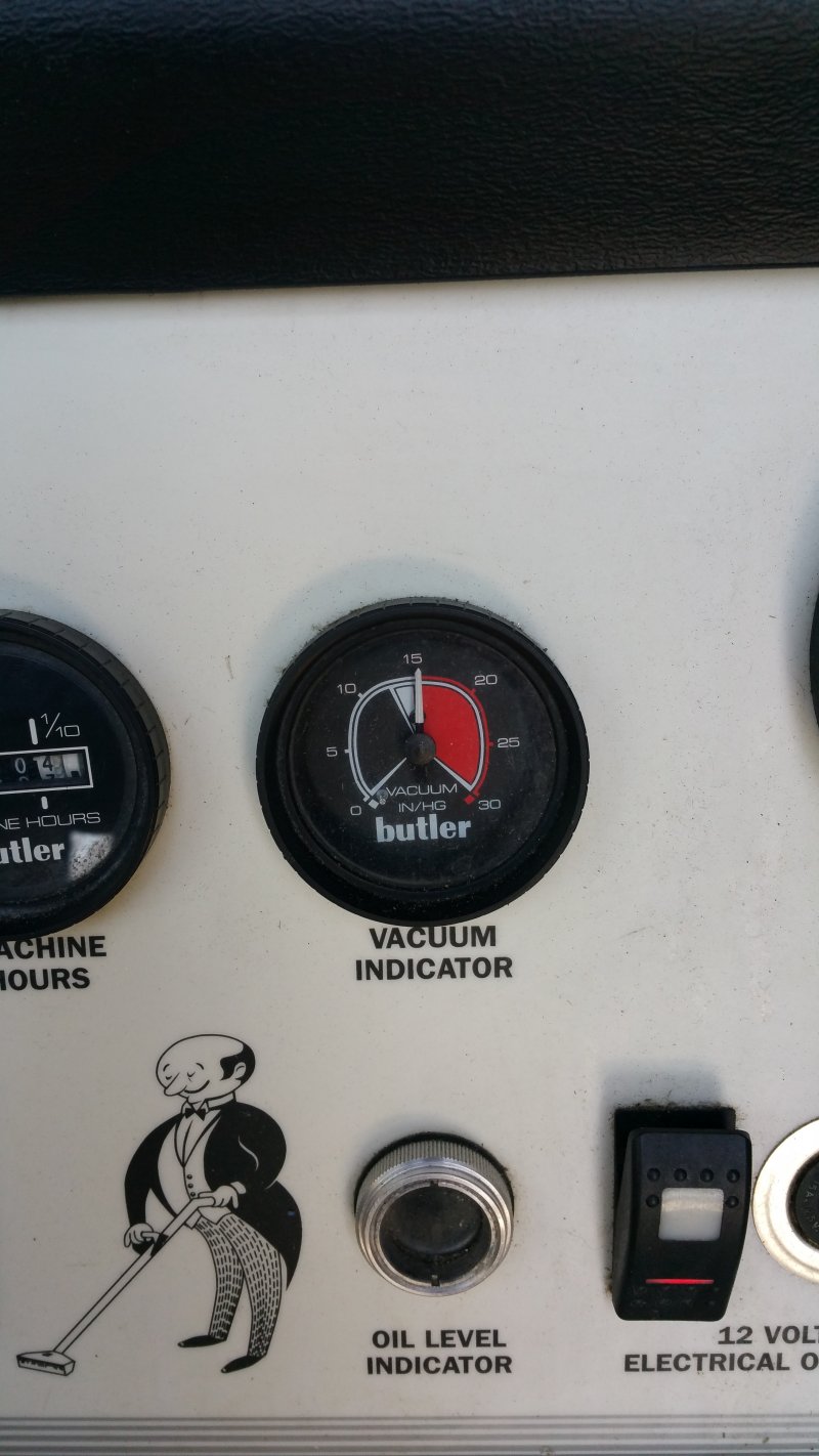

My understanding is Butler has a solid shaft?
What about the 13" of lift?
Too low for me.
I don't know nothin about no u-joint so I can't say what Sapphire is doing there, but I run mine at 15" and used to run it at 17" without a hickup (but the gas consumption was bothering me). I tried to run it at 20" and 2000 rpms but the belts started to make funny noises after an hour or so and the blower made wacky boggy weirdass sounds so I said turned it down to 15". The system can easily handle 15"of lift as the shaft is more robust than the one on a Butler.
