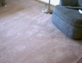

Eddie could you post some pictures of your 360 swirl marks in carpet?
I can understand wand marks looking pretty but I would like to see your artwork using the 360.

He was wanting pics of the 360's swirls.
Here is one of the old style.

Greg......we ain't interested in seeing the old ROTOVAC swirls!
