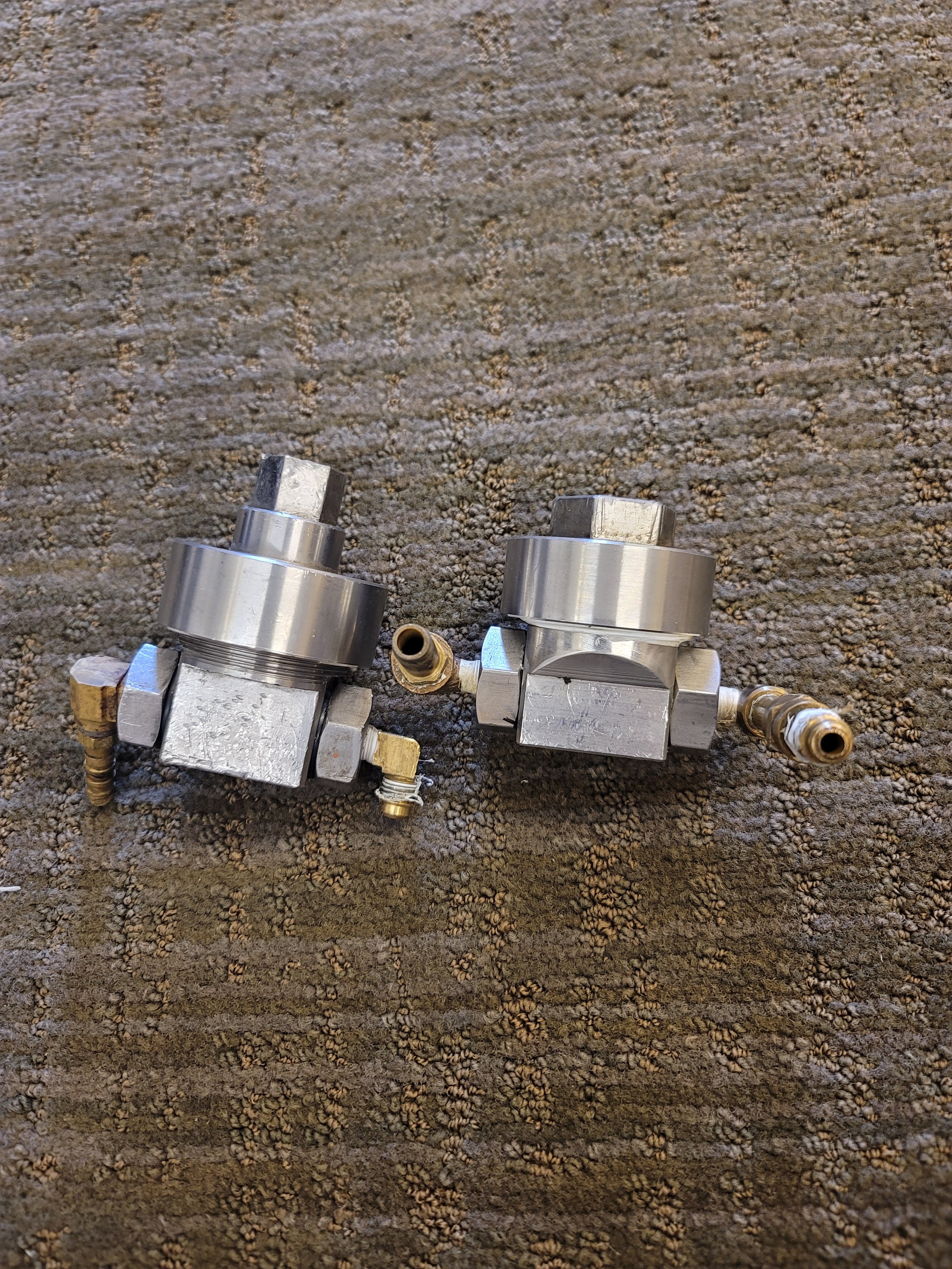

This diaphragm has seen better days. This pump could have gotten knocked up.🙃 All the o-rings were in equal shape also jamming up the check valves. 20230418_190925.jpg

I tried to swap out pumps from my Boxxer to my Everest and it didn't work. I thought the pumps were interchangeable? Odds are that maybe the lines and everything else need to be replaced as well, but for future reference are the pumps interchangeable?
11,288
No the make a diaphragm and new check valves for the one that came off the everest
Thank-you, Sam! I'm in the process of ordering parts to rebuild. It takes a little internet work to cross reference the parts. I'd order from Jon Don, but they mark up the pump alone $100 more than everyone else.

24,024
Be very careful when putting that back together. It's made out of stainless steel and if you damage the threads you are done.
