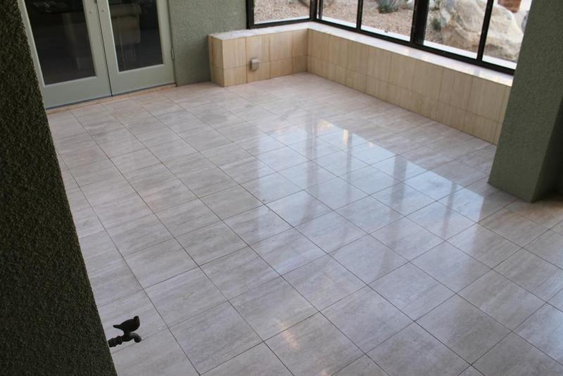

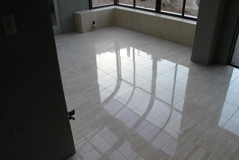

Here is a before and after of a floor with bad lippage. You can see the reflection jump, but it has a consistent polish.
