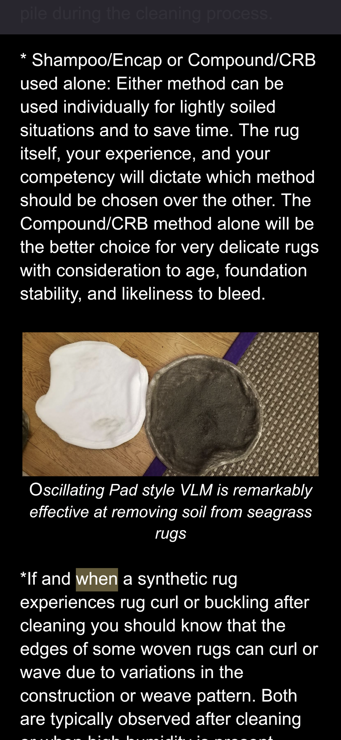

Have you cleaned Sisal rugs with it, and do you have before and after photos?

I've OPed sisal a few times over the years. Releasit DS and cotton pad. No prob.
That's what I used last time. I'm sure Tops juice would work well.

I HWE a sisal rug at the Mrs Doubtfire house. it had alot of pet stains. I inform her that I could remove some of the yuck, but the stains might only lighten a bit. The rug buckled a little but went back down with time.
I'm just thinking the TOPS might be better and less risky.
Damn! Why couldn't the TOPs have been the Tool dejour b4 the Cimex!!!
