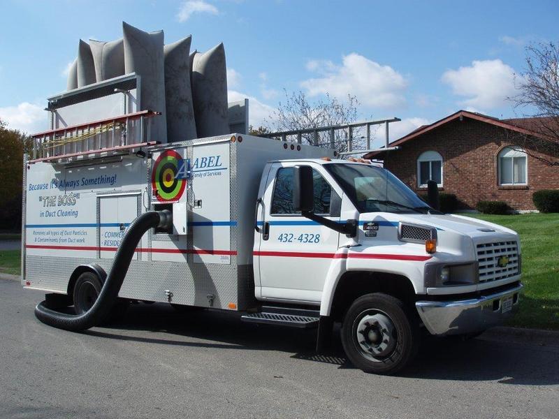

Unless you're willing to go pro with one of these..
Don't even bother..

If you want to find out a bit more or come out cleaning....we have a large trailer mounted unit (PVT) and also a very large portable....
But, there is a lot more to it than just running a brush down some a vent....
Negative air pressure key too....
But if want to really check it out...I can get you together with my brothers Dave and Kirk in Bemidji....
