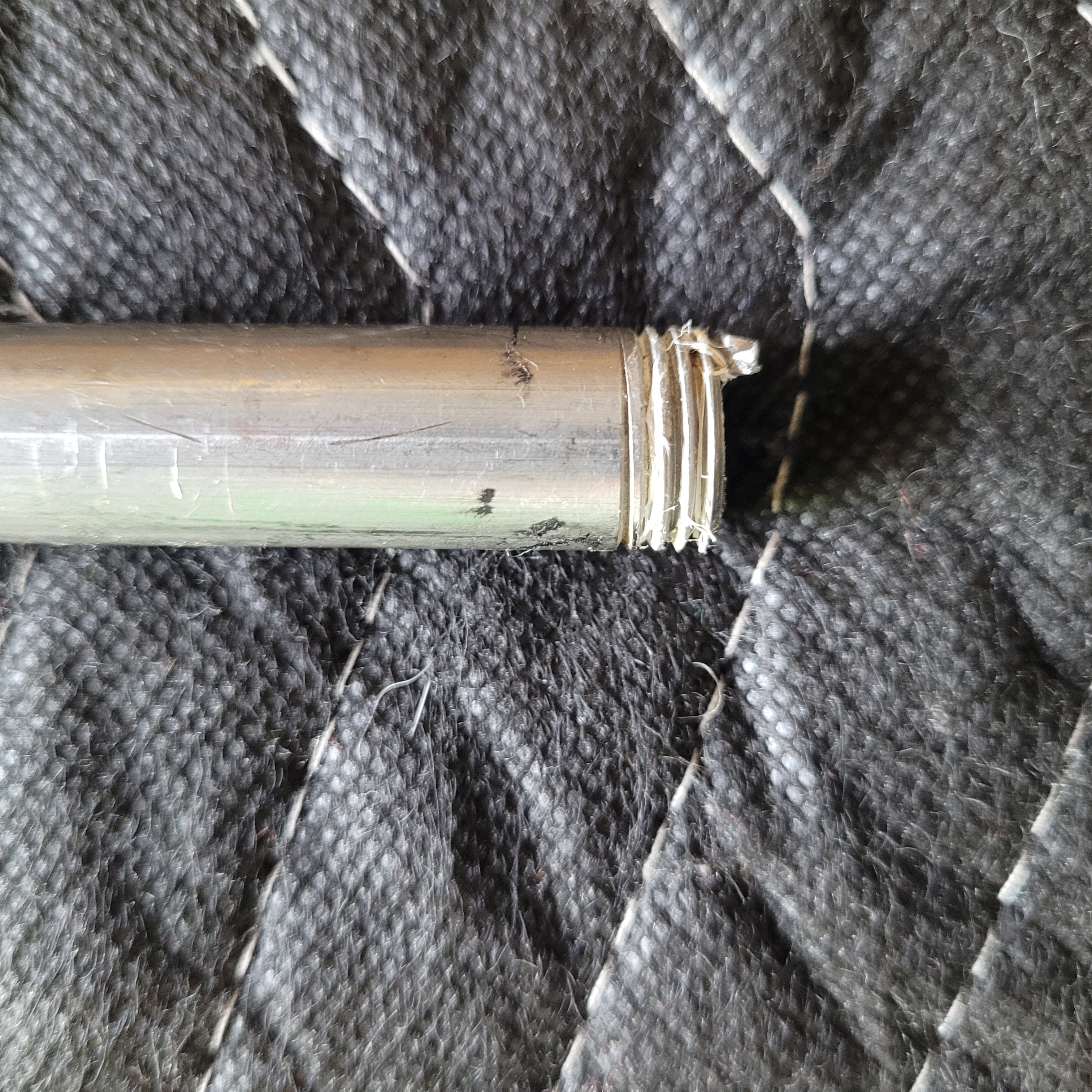

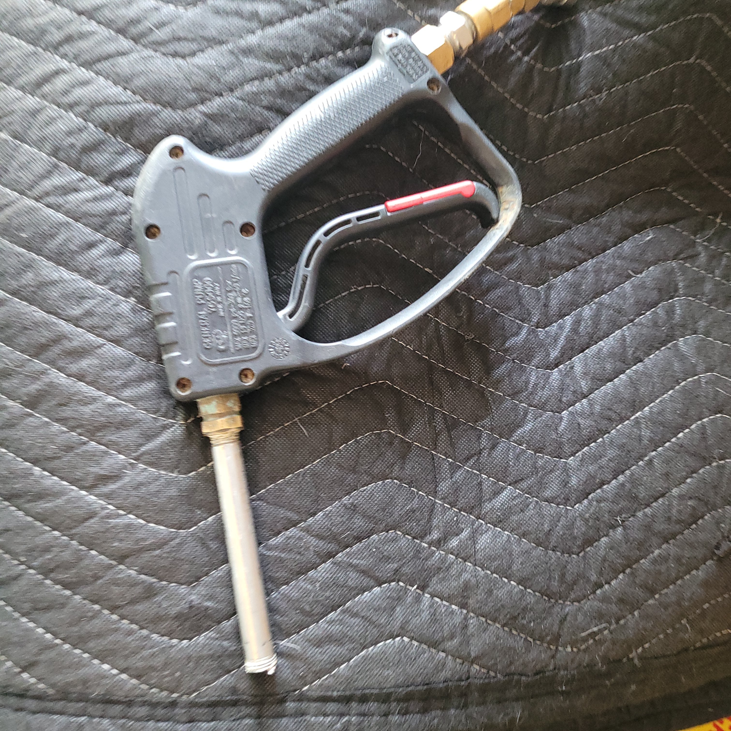

It's not that hard to fix your wand
It’s been through hell I want to change all the lines and I guess that’s the part I don’t know what to buy or where to take it
Not just the main line the metal lines that go to the “jet bar” also and then put new jets in it and a different trigger I squeeze to hard and always mess up the sapphire ones
Then a new handle and glide
Not just the main line but the metal lines that go to the “jet bar” also and then put new jets in it and a different trigger I squeeze too hard and always mess up the sapphire ones
You are right, it can be tricky to remove the pressure line going to the manifold especially where it attaches to the lines before the manifold. It requires a lot of patience and ingenuity, sometimes a heat gun, since connections ( even steel&brass) can get stuck. I'm not familiar with the Saphire wands, but you can benefit from a soft touch valve, so when you trigger for hours, you won't feel a thing. Can you snap a picture of the manifold, pressure line
( rubber or steel) and the valve, so we can have an idea of what the problem is.
Is that a 4 jet wand?
