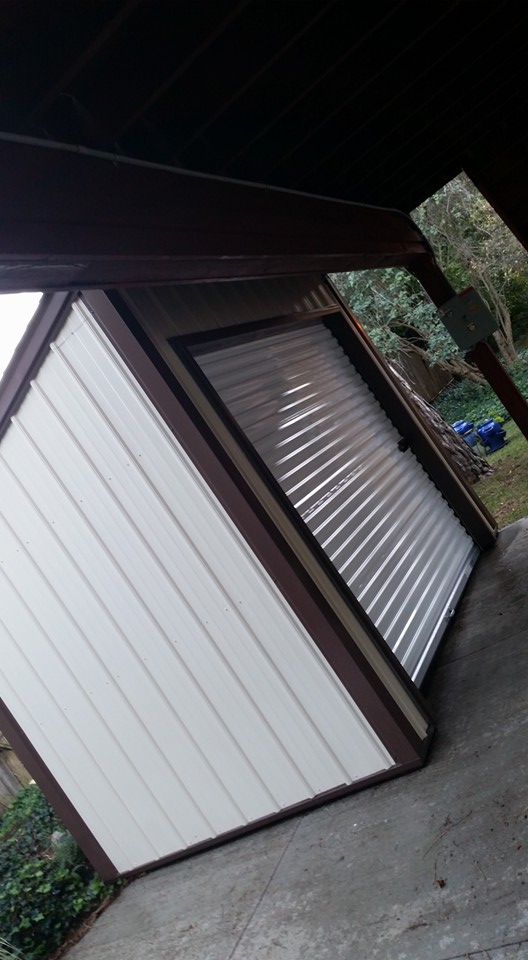

We are building a shed (Dusting Room) to house the duster, it will be built adjacent to one of our overhead doors. It doesn't need heat, all it needs is electricity and a large garage style door to easily load rugs into it. This way the dust and mess will no longer be in our cleaning plant. We will also install a dust collection system in the dusting room. We will insulate the room and be prepared to heat it if we find it necessary.

Everyone does their own thing. Some have their motor outside of the containment room. We boxed it in within the shed and gave it a fresh air vent on the side of the shed,

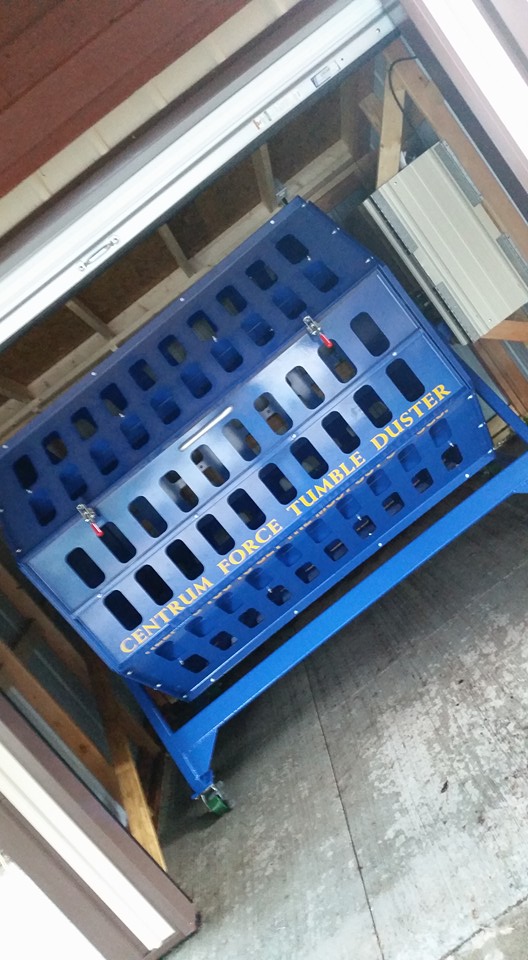

Yet most of the facilities make an enclosure. Almost all put in an exhaust fan or what you describe as a woodworking vacuum system. 12144936_1196778597002882_3027826229285188525_n.jpg 12072732_1196778620336213_2094625342414549793_n.jpg
Heavy stuff accumulates on the floor and is swept up periodically. 3 piles shown here from ARCS day, just before Rug Summit 9, was what came out of the rugs shown without the aid of a human. Except of course, the initial loading them in the tumbler.

This is my personal Tumble Duster at Area Rug Cleaning Company. I have it outside. There is an exhaust fan located in the back of the shed not discernible in these pictures.
