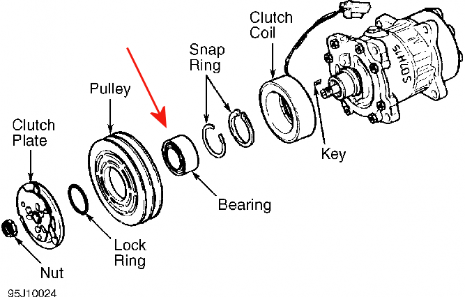

When the pto clutch is not engaged the pulley spins on a bearing. When you engage the clutch the pulley locks up solid to the shaft and the bearing no longer spins. If the noise goes away when you engage the pto clutch then your issue is almost certainly the clutch bearing(s).

The good news is the bearings can be replaced, and relatively inexpensively. The bad news is if you let it go until the bearings grenade then the clutch and possibly shaft could be damaged. Get it fixed sooner rather than later IMO....

Yup. Here's a pic. Its an AC clutch - same thing basically.
