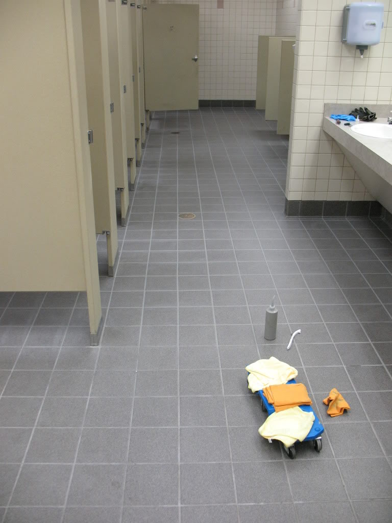

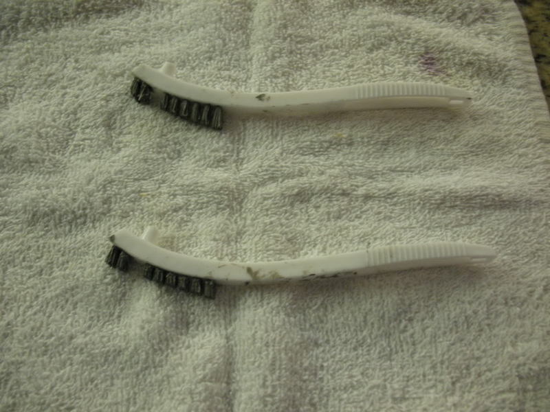

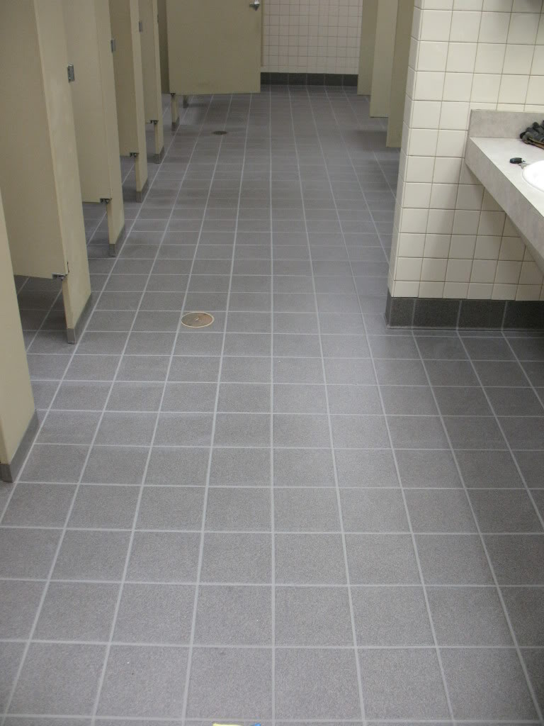

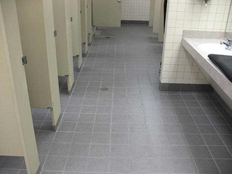

Here are few pics from the job.
About wore the bristles off those brushes!!

Josh said:
Did the dude in the first pic know that you were snapping away? :lol:
Good eye. We closed the bathroom with caution tape and cones to start cleaning. Dude walked right in and said, "can I use the jon"? Still had them walking in we had acid all over the floor and pressure wand going. Love those call centers!!
