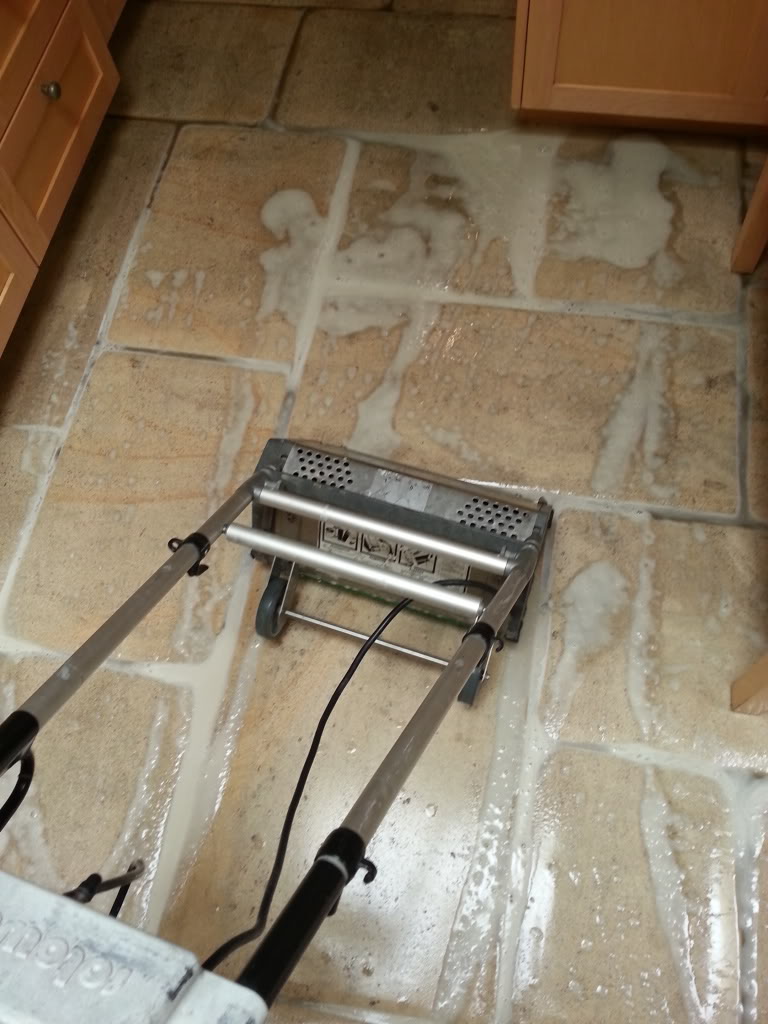

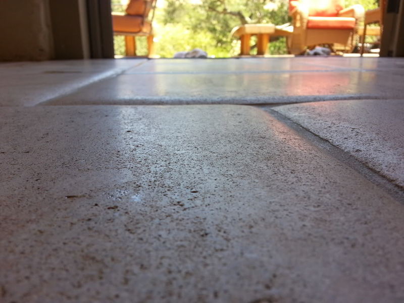

pretty much the worse floor material ever.
116,968
porous/pitted Limestone...
Like living on stale wonder bread.
half cleaned..

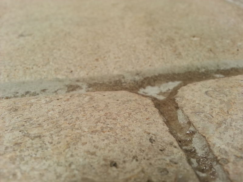

Homeowner has done everything wrong with the floor.
-Uses a Shark Steamer
-String mops
-Applied a topical coating three times over 9 years without proper cleaning.
and never mopped up the excess topical in the grout line after they made mud with it...
http://youtu.be/noBN531F7Q0
Only scraping/grinding or a gel based coating stripper is going to get it off..

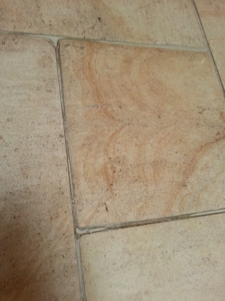

That is a very expensive floor. Pillowed Beaumaniere Limestone, we've done quite a few of these.
This is where Klenztone does a good job.
as far as the topical, that last little bit here and there is the hardest to get off. It sucks they had to put so much crap on there.

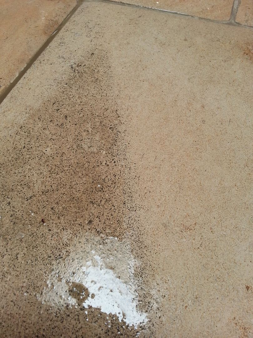

What product and technique would you use to get off that residue Cameron?
Our Stripper/ Oxy mix didnt even budge it.
problem is he does not know what he applied. other than it looked Milky.
116,968

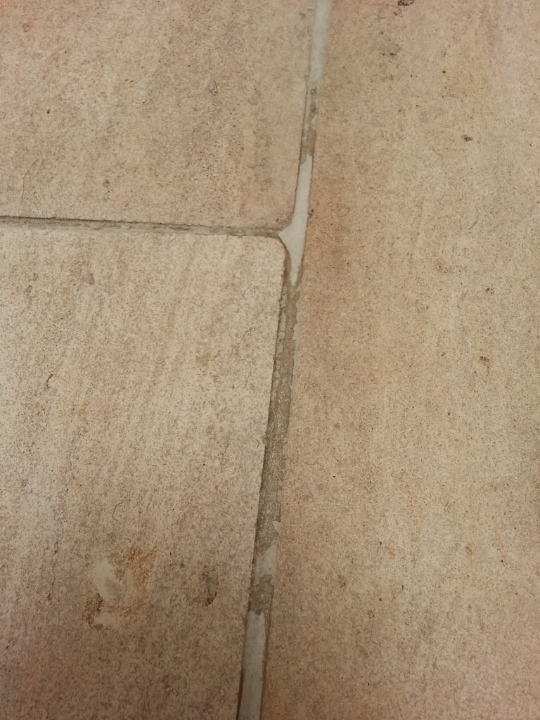

I have to think they contaminated the topical with dirt from the un-steam cleaned floor. They admitted that they did not wipe up some of the puddles in the grout lines....hence the brown plastic all over....

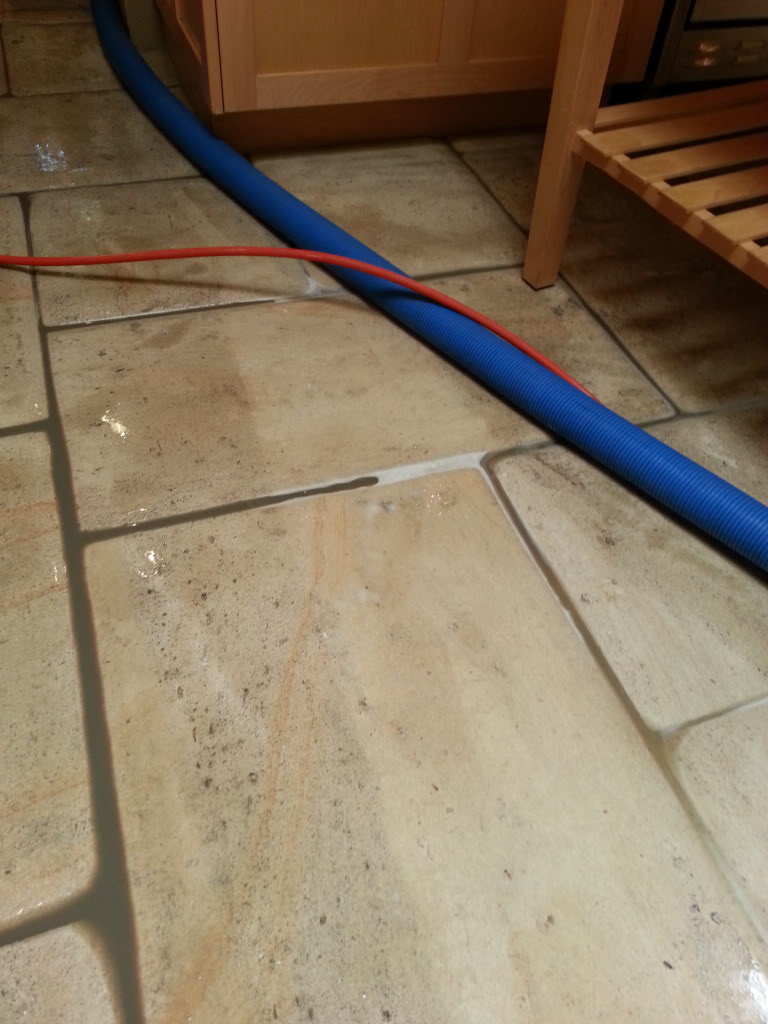

kick the diluttion a litler higher....no oxy only stripper....
and then wait, wait..
scrub, rinse and repeat......
only thing you can do

Methylene Chloride
for the dirt, Klenztone i the best, but you have to protect everything else.
I have a client with 40,000 feet of this that I service several times a year.
116,968
I think I'll stay away from the methylene chloride...tried some real strong floor stripper and not a damn thing budged..looked like hell...grout saws and THEIR knees are going to have to do it.

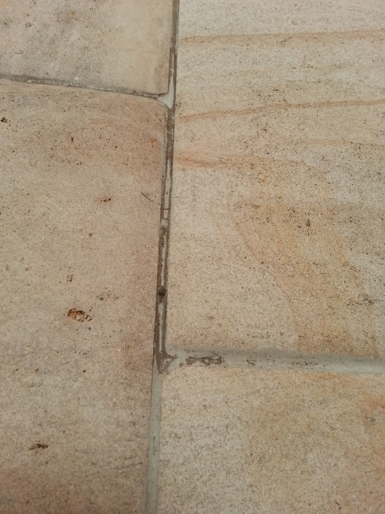

didnt budge???
then it aint acrylic....
urethane of some sort, and bonded to cementious grout lines......uhhh yea
116,968
yeah, they didn't know. they did have a empty bottle of a Bona stone topical but they said only the maid uses it.
Hubby said the crap he used was milky...
