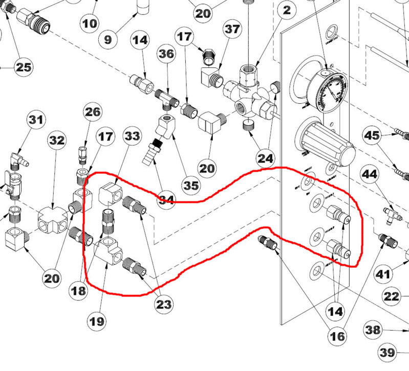

Interesting. According to the manual the two solution outlets are simply teed together:

Are you using an external pressure gauge that you plug in to the QC?
