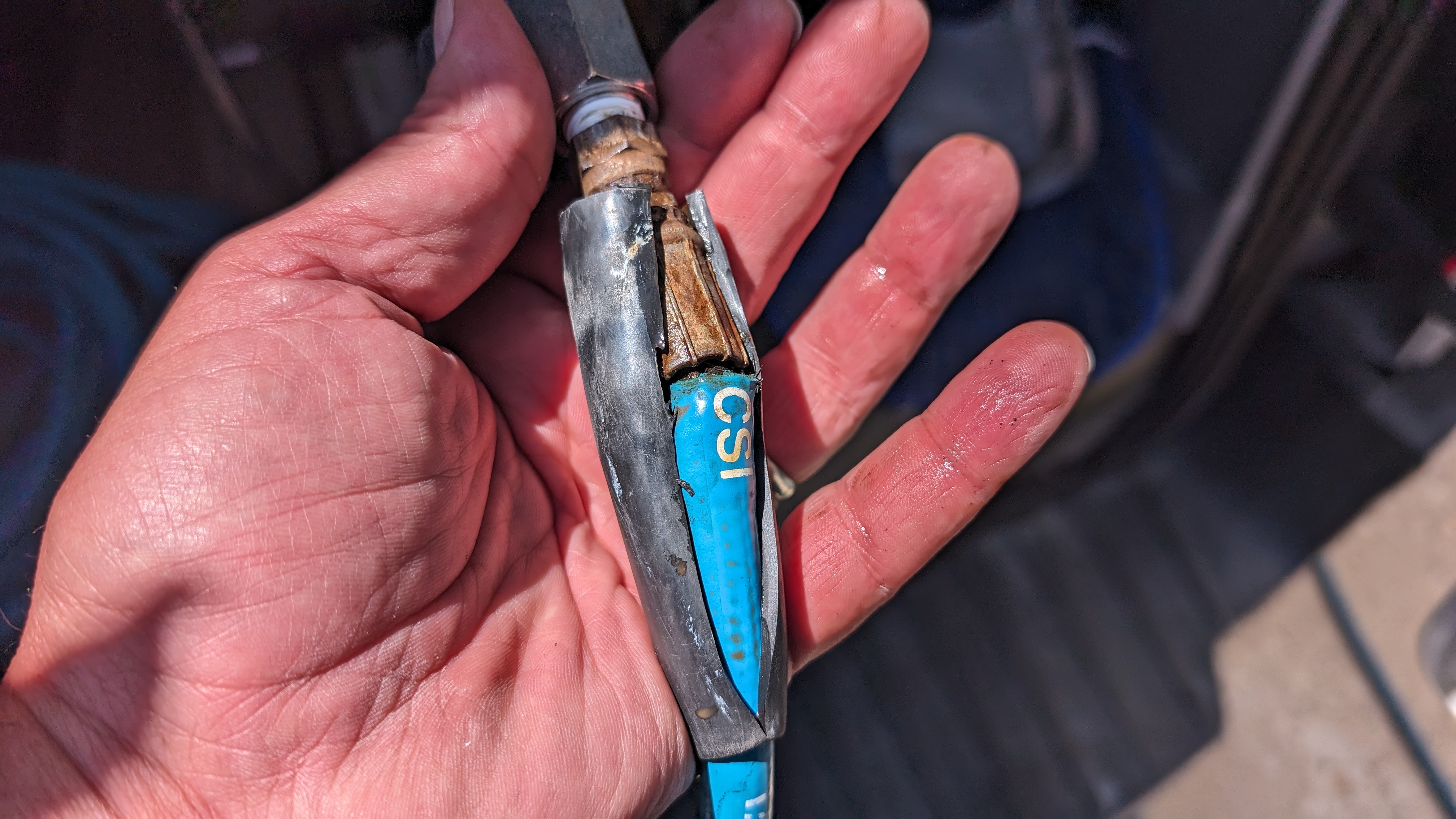

pOp goes the pressure hose...
117,248

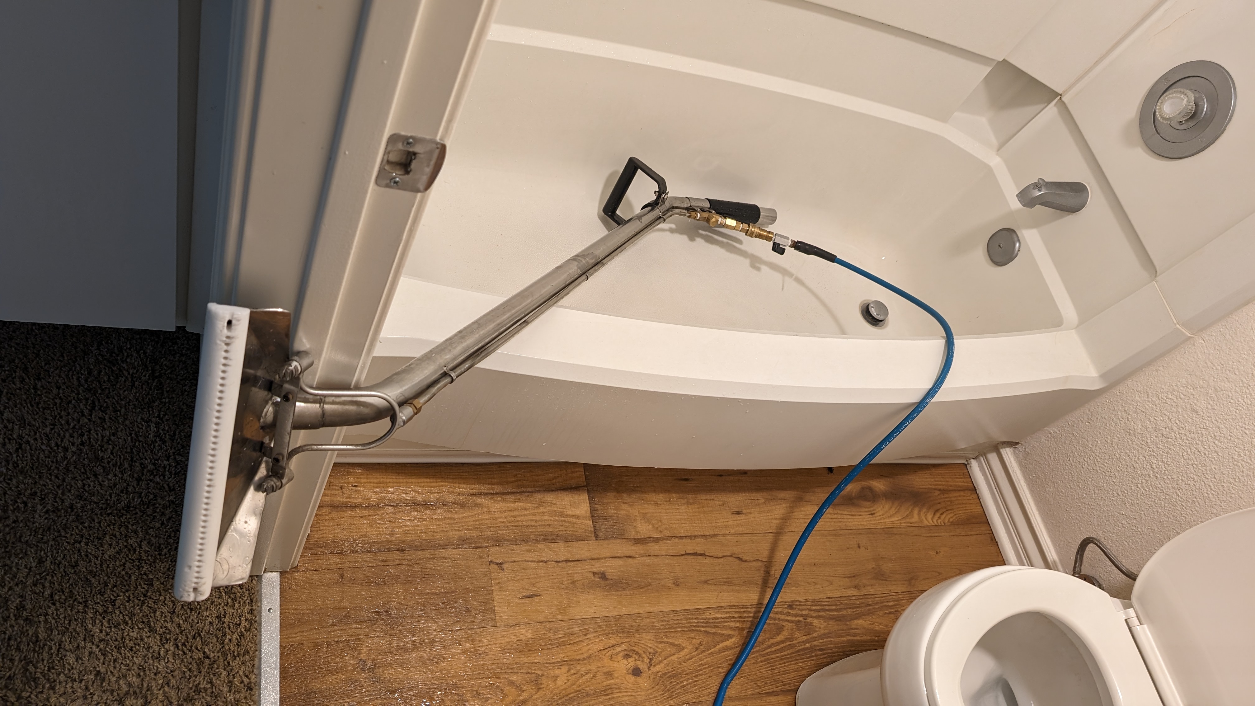

It's been a long long time since I've gotten soaked and soaked a house.
Gives me a good opportunity to try this stuff..
Reactions: Living The Dream
14,626
with the rust on that crimp, it looks like it's two years old

I wouldn’t ever consider using stainless braided hose. Way too heavy among other reasons.
50,007
Brister sells some neat in-the-field repair couplings.

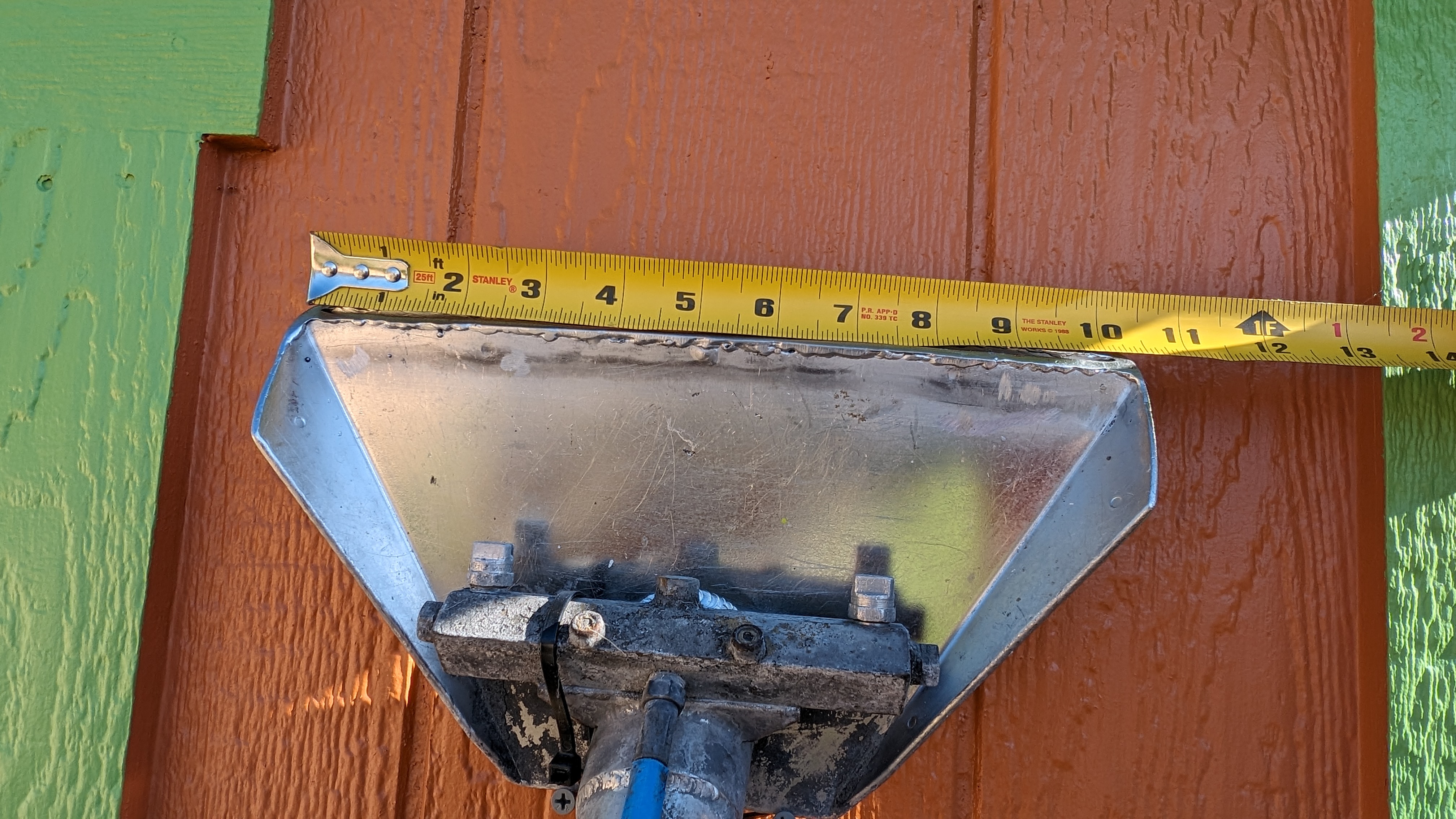

The Tri jet is many pounds heavier
Has a unnecessary third jet, which mandates a spray manifold which causes drips/drainage
It's jets are not at the key 45° angle
Uses a horrible Glide system that needs to be glued on so interchangeability is out the window
And most importantly, I'm not willing to wear my joints out so that my customers may or may not enjoy carpet that is dried 3 minutes quicker.
The dry times on this wand are already ridiculous, not to say I haven't tried running 2-in hose to it with use of adapters, but the benefits don't exceed the negatives.

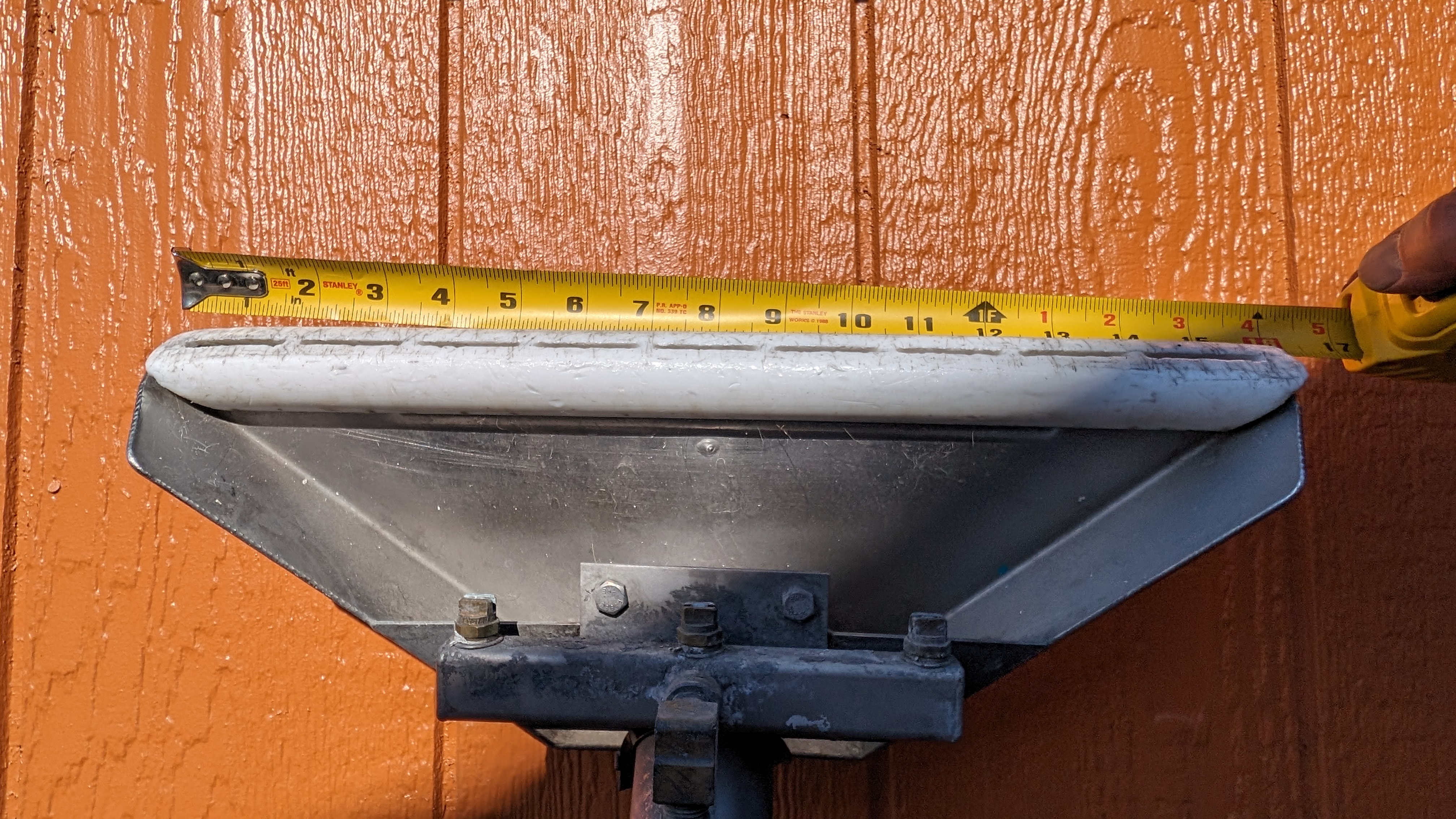

I think he's saying if you can tell westpak to make a 12-13" version of your 530 with 3 angled jets, it'd be an awesome wand

And it's ten inches wide...
