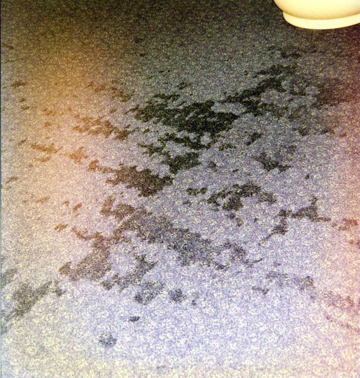

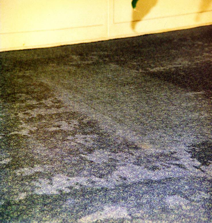

I can't remember where I aw this photo, who posted it or what board it was on but is a classic example of it.
Carpets that are prone to it (usually the higher the density and quality seems the more likely it is to happen, will often now have a clause on the rear of the sample warning of the 'naturally occurring phononemen'. I have seen it on the back of a couple of sample here in NZ and they are not usually replaced as faults.

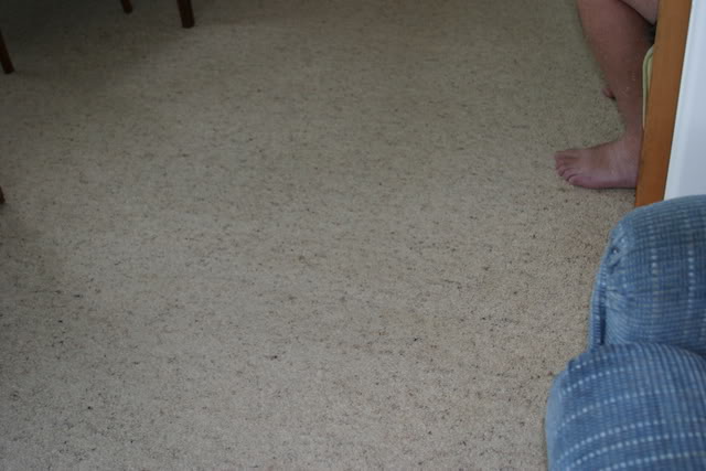

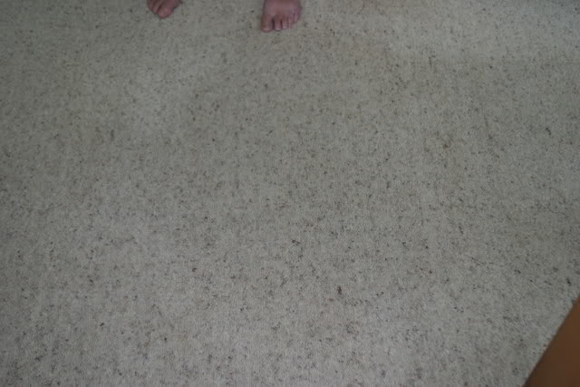

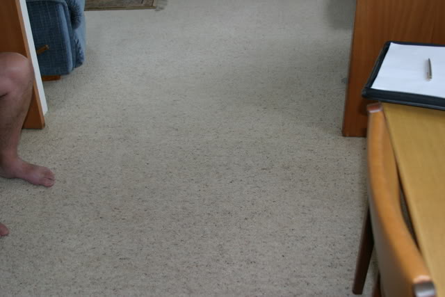

Here's a job I was called into. It was a approx 5 year old wool carpet that had been spot cleaned following an accident. Took a while to dry and recleaned but the 'stain' remained. But only visible from one angle.
These homeowners claimed for replacement carpet.
Problem area viewed from the side.
Viewed from the lounge room.
Viewed from the Kicten side of the dining room.

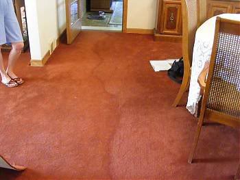

Here is one from the Orlando Convention Center, had just installed 300,000 sf of this and this pile reversal occurred almost immediately. The second photo was where the attempt was made to correct this. While it did a fairly decent job and the management was pleased with the results, we waited 90 days to see if it would hold, it did not. It reverted back to pile reversal. I was called in for the Knoxville Convention Center and it had the same condition. In Disney properties I have had it come up several times with very large runs of carpet, one in a time share that had put down 44,000 yards of carpet and it was pile reversal all over the place.
pile reversal, note the seam in the middle
area that was corrected
sadly the quality of these photos are not very good but hopefully one will get the idea.
