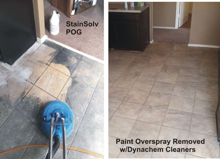

One of our customers posted these photos of a tough paint removal job he had :
He used our POG and a little StainSolv . . .
Photos courtesy Ibarra's Cpt. Cln
