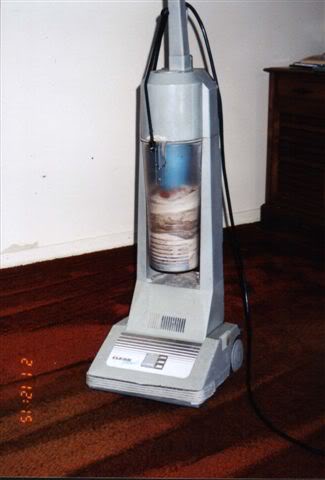

I was thinking of trying a vacuum when doing the cleaning demos. Didn't think anyone would have a Cleartrak down there, but a Bissel Powerhouse or anything really with a clear cannister would do. Be interesting to see whats in the carpet before cleaning it.

Bought my first Cleartrak in 95, took me a while before I started using it consistently. I’ve gotten lots of rolled eyes in my direction since I started talking about vacuuming. If it weren’t for me seeing all that crap come out I would have quit vacuuming long ago.
