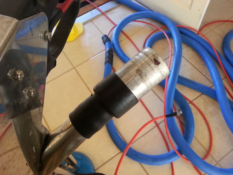

one piece 1 1/2 to 2" adapter, who makes one

They sure do. I always kinda hoped mytee would come up with something better.
Sent from my Nexus 7
Scott Rogers
1,033
8" of 1.5 inch hose with a 1.5-2inch cool cuff/mytee cuff attached is the way to go. use just enough 1.5 hose to cover the tube of the wand and attach the cuff

I wrapped enough duct tape around mine to make a stop for the 2" hose.

Mike. I used the one you show for about 2 months and also didn't like them. I have used the gray one that Kevin posted a link to for about 4 years and they work well. I keep one on my uph tool and a different one on the turbo. Much better than the metal & black piece of crap

This is all I have ever used:
http://www4.cobbcarpet.com/zen/index.php?main_page=product_info&cPath=68&products_id=3613
You have to thread them straight on the cuff though and the 1 1/2" part tends to stretch out a bit where it attaches to the tools with heavy use.
I've been recently using this one, but just sticking the 2" on my vacuum hose straight into the threaded end on the cuff. It's been working, not perfect, but better than the alternative. We also have a piece of 1.5" hose as stated above. The vacuum decreases too much for my liking. Use it mainly for the stair tool and the smaller hand tile tools for doing showers and counters.
