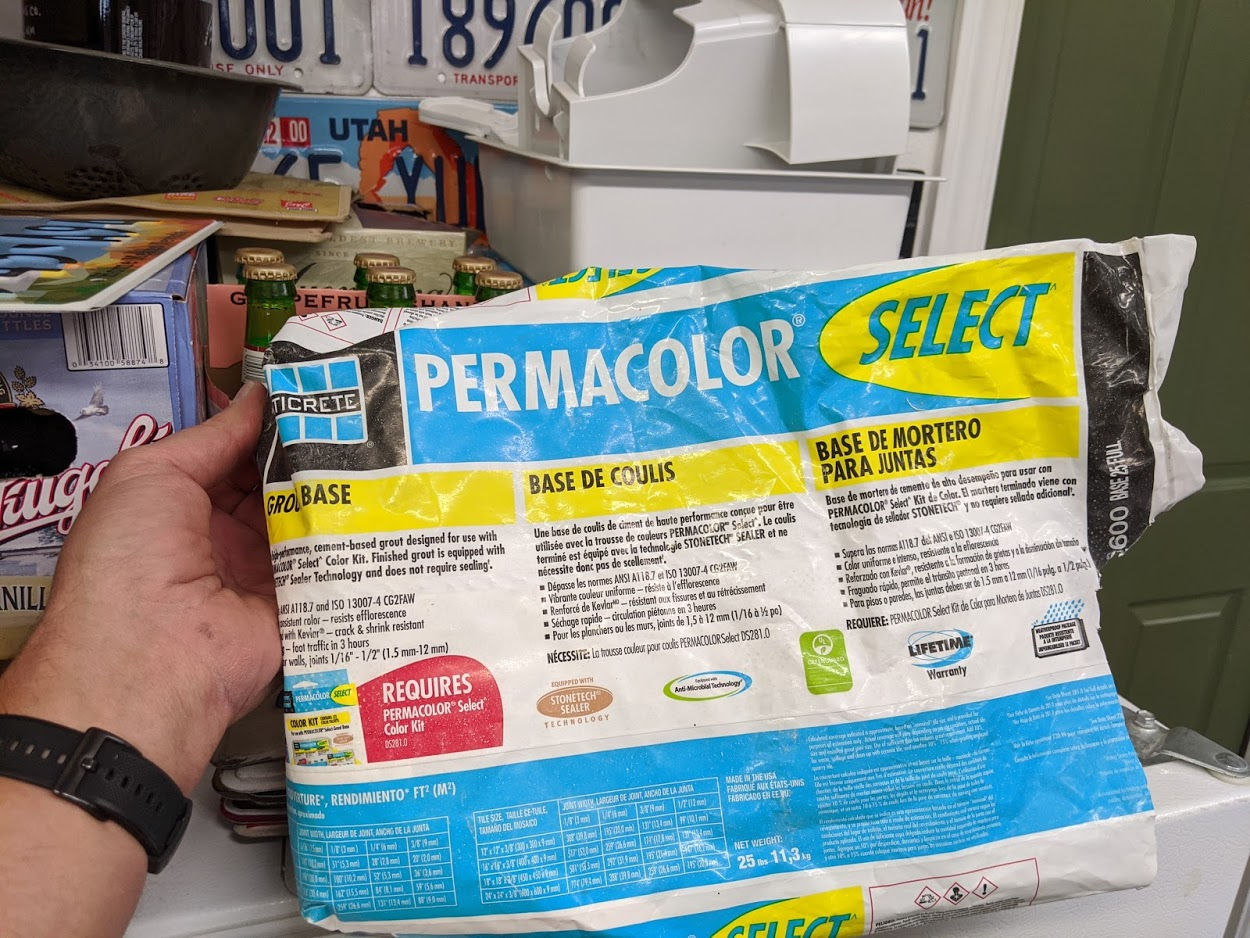

Ive heard of the name Laticrete before but this is the first time I've had to deal with it (if they go for my bid)
So you buy the "base" product, sanded or unsanded and you add the dye/tiny to each batch...

Most installers mix tiny amounts of grout up at a time to keep the working time longer. Technically, the entire bag of grout is to be mixed at one time. Laticrete solves some of this problem by mixing one dye pack to 12.5lbs of grout, giving better color consistency than mixing partial bags.
