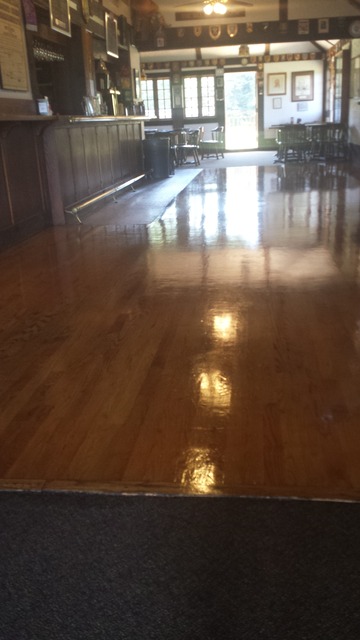

My Aptos house wood is done...
All that work just to let dust, grit and pooling fook up the finish.
Only a floor geeek like me would notice but good lord.
Dont skimp on the most important part for cripes sakes..

I did my house in Michigan and was out talking to a neighbor and looked back at the house and the dog was looking out of the window of the room (36'x20') of the room that
just received a second coat of finish. Needed to screen and coat 3 more times to get paw prints out.

Will it stay adhered to the old finish? That is not a real aggressive pad to prep with is it? I use Woodstar by Pioneer on some commercial accounts that is a floor finish that can be burnished and they recommend using a black pad. If I were doing a floor with conventional finish I would screen or use a 3M prep pad.
Keep us updated on how it works out, looks good thoough.
