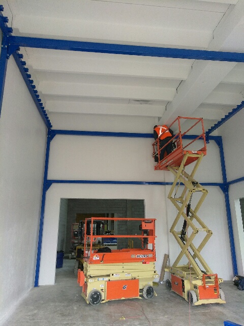

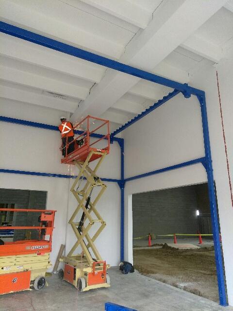

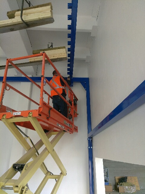

The vertical connection in the ceiling looks potentially weak to handle the load. What did you use?
What are you secured to in the ceiling to carry the load you lift?
27,862
We've drilled into the concrete and installed concrete anchors that spread when you screw in the eyebolt. The poles are only 12 feet wide and the largest rug I do is usually a 10 x14 so the weight is usually 200 lbs or less. I test them for movement every once in a while and so far they are rock solid.

The pulley system looks good. Be careful with how you secure into the ceiling structures. Especially in the instance shown in the above pictures.
