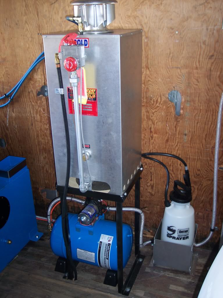

I have a 3ht propane heater. My stem for the fresh water intake broke because of the vibration. I fixed it and had to replace the steel coated water line because it started to leak. I went to Jon Don and replaced it with a stiff heavy duty line. I moved the propane heater off the TM frame, to prevent the vibration on the coil. The stiff replacement line I bought still vibrates the cold water intake stem pretty good and want to avoid furthure damage. So my question is that:
Can I use the typical steam line as a replacement for the my lines going in and out of the heater and do you think it would reduce the vibration on the stem. I never run over 500 psi.
Thanks
May 12, 2007
2,242
use 1/4 '' pressure hose and a pulsation dapner.

John Middleton said:
Les,
Is that heater SAFE in that position? Combustable lining beside (almost, if not touching) the heater? Closing off the vents in the base.
John
ALL is good with the set up it's been running for 3 year'now.
I have a lot of setups like this running .
R
