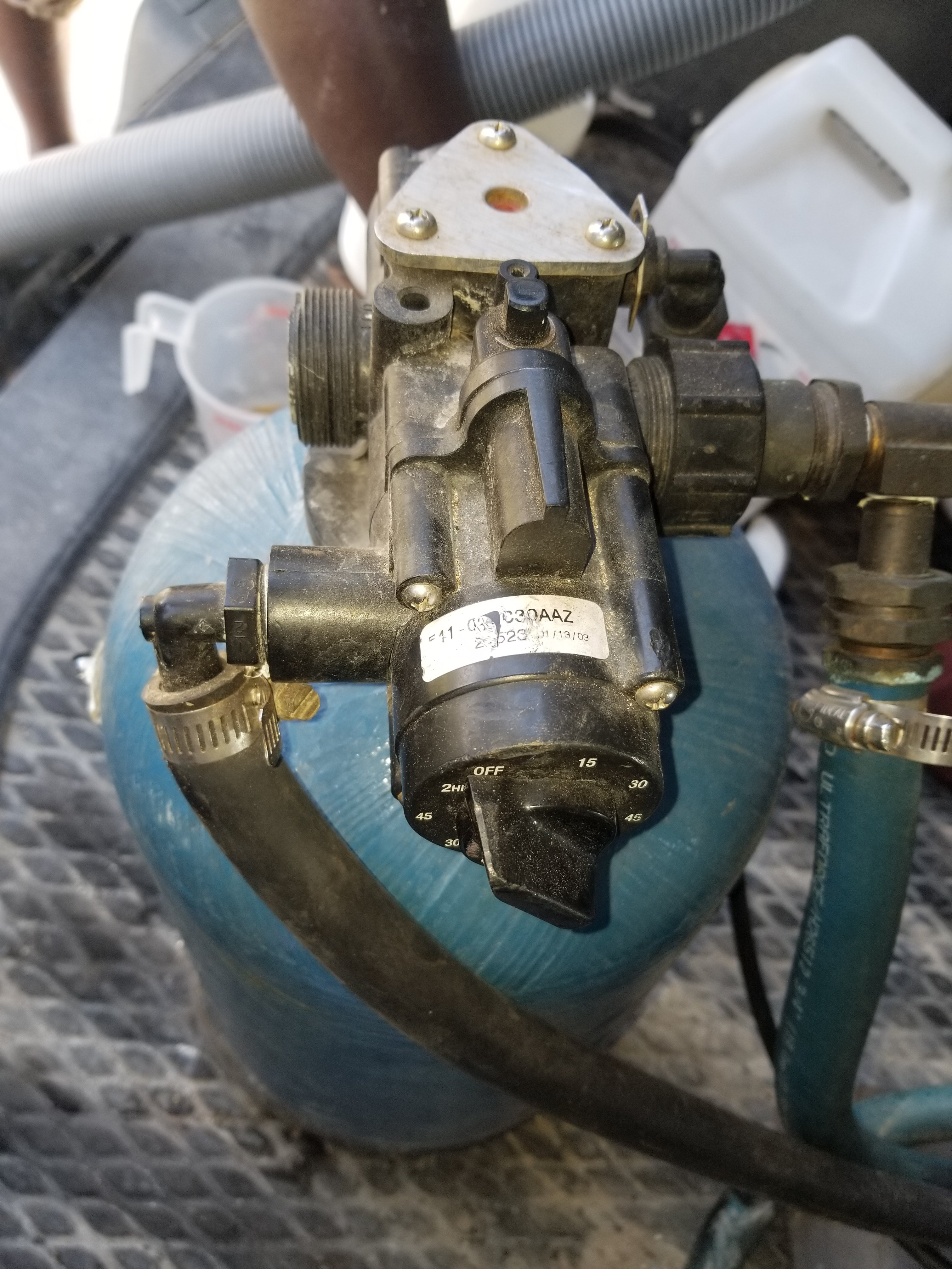

Some basic questions... Please understand that this is a learningexperience for me. I know some of these questions are very basic. The truck is not local to me but we will be working on it this weekend. Any input would be appreciated.
1. The "Clean Water Tank": I would like to know the progression from intake hose to Truck mount. Does the hose water go to the tank first, then the "pre-heater", then the super heater, then the machine? At what point is the chemicals injected? (I know this may vary from one manufacturer to another)... I also want to know what kind of pressure the lines before the heater should be expected. I am thinking of repiping some of this using PEX tubing and sharkbite fittings. I want to make sure pressures will be within ratings. I believe there is a softener for the incoming water as well. I assume that the softener should be before the clean water tank
think this is it
Valve – Erie 541-030 Egg Timer Softener Non-electric
****may not be exact model
