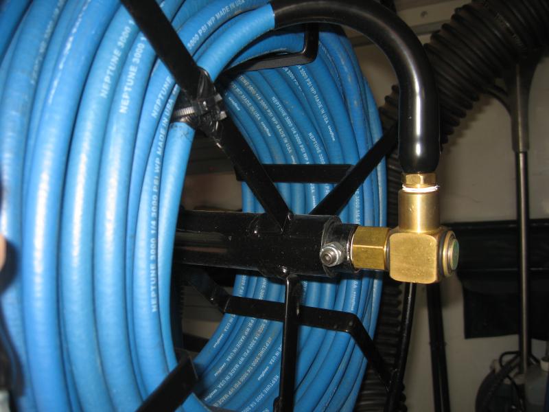

Some ideas maybe here for you on our set up. Live reel yet when needed, but never use a live reel unless fully pulled out.
I have a number of videos on my YouTube of our Butlers set up.
Reactions: Lorenzo
WE have live vac on the Butlers but not live solution. The heat would cook the hose and even melt the interior of the solution hose reel. None of our Prochem's have live anything.....not even tech's. We use robots! :winky:

all the machines I have had......everyone had a live solution reel......not once have I ever cooked or hurt a hose......it will discolor..but that's about it...........
Its done it with the stock Butler hose and worse with the Nepture. Discolored and brittle the rubber even broke down in the stock hose. Haven't had the issue once we disconnected the reel.
Jim do you un-spool the reel at every job?
Jim Martin
Arizona
Jim Martin
no never have.........I just pull off what I need......even for as hot as that 570 gets.....I can't say I have ever hurt one......
Reactions: Mark Saiger
Man I wish that were the case with us. We ruined a lot of hose before we finally gave up on live solution. :errf:
It even distorted the reel from the heat. I'd have thought you'd have an even bigger problem with it being out in your temps. :confusedd:

The biggest issue that we see with a live solution reel is that the swivel (we use Rokan's swivel) is a wear-and-tear part. Don't have much issue with live garden hose. I think both have the ability to make life much easier. If you go with a live solution hose, I'd recommend longer length hose, maybe like a 150' and two 50', and put the 150' on the reel last. Would definitely stay away from live vacuum. We do put a remote port at the back of the van, which makes life easier, too.
A real nice touch is to do an electric hose reel with a dual stand bracket in from with your solution and garden hose reels right there. Saves a good chunk of room in the back of a van.
Jim Martin
Arizona
Jim Martin
windtrax.........part number 7475 is the swivel..
and part number 7475K is the rebuild kit....
about $30 for the swivel and $12 for the rebuild kit...I have used these for years on fresh water....solution...and my APO... and only had to rebuild one and it was on a fresh water reel....
