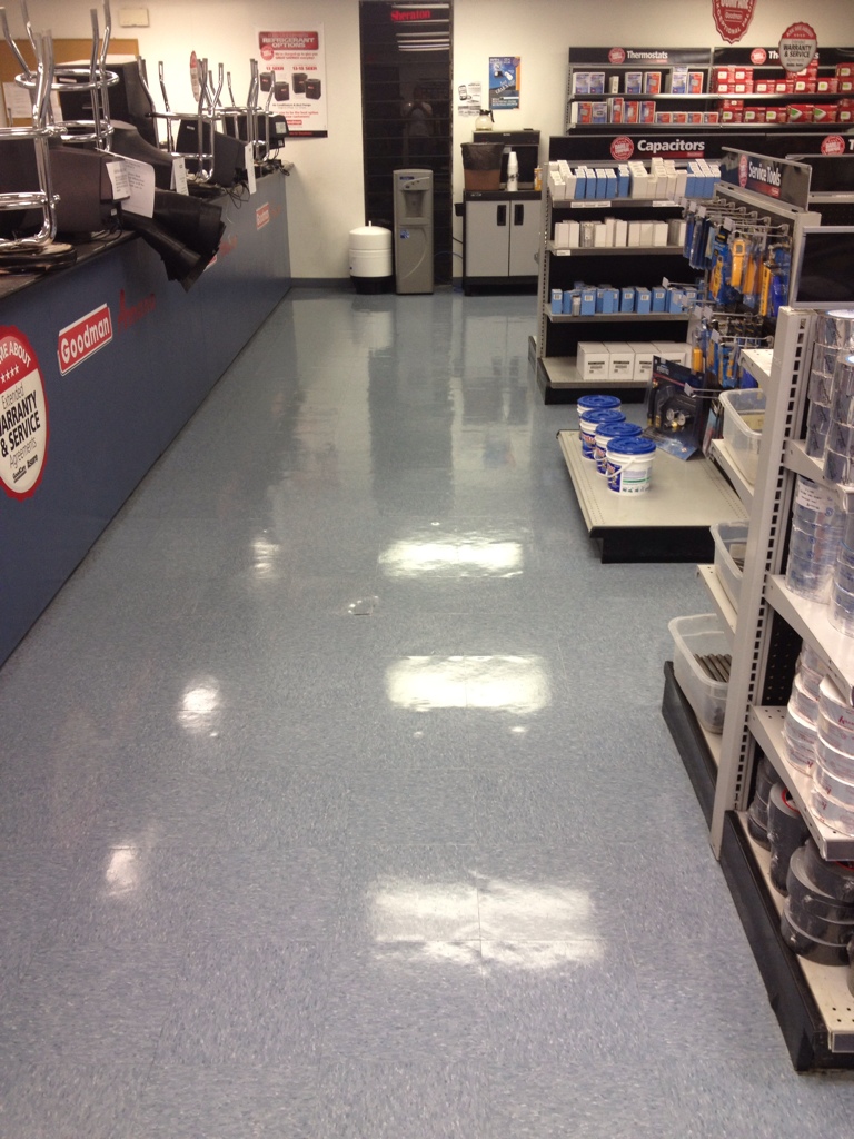

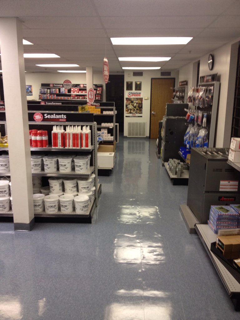

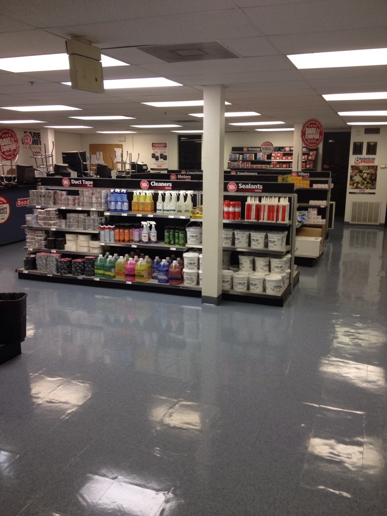

Greetings I would like to thank you all again from all the help and advice .I finish the job this past week end and here are the results.
Thanks
