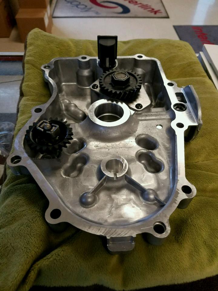

My Kohler is going in for a transplant tomorrow
115,961
Back end has an oil leak.
I guess it so common than Kohler has modified the back to help the RV THREADS do its thing..
See that bevel on the lower inner edge?
That's where the RVT will gather to do it job..
Kohler is covering the whole tab.

Hmmmmm, mine has the same issue.
How much was the new rear cover? Install? My research - it was difficult to find the cover and was like 400+ just for it. Plus install. If they let you know, let me know.
I need this repair or a new engine. Ugggggg! Or just let it leak(not a lot, just annoying) and keep my money. Start over with something else, maybe.
http://mikeysboard.com/threads/paid...-month-a-crack-in-the-engine-uggggggg.284111/
14,086
If I were you, I'd just get another engine. I don't know your budget, but if you can afford it, go for it. It'll give you at least 5years of no payments. But I remember you saying this truck mount is nickel and diming you to death. Is the nickel and diming the same as a monthly payment, or are you losing any work on downtime? If so, get rid of it, and get a shiny new toy
