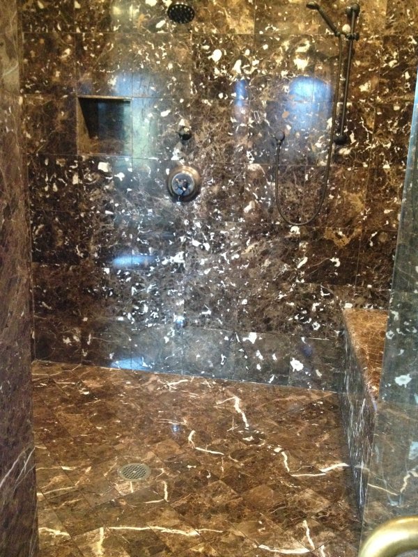

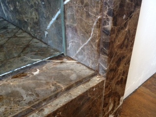

This is a bath counter top I did yesterday, both pics are from the same area... Powder polished, and sealed.
I did 3 baths, and made good $$$
View attachment 1373 View attachment 1374

Monkey pads could be used but why? First the pads, if started at 800 grit, would not remove the chemical burn, and damage shown in the first photo. In order to remove that damage the starting grit would have to be at least 400 if not lower. We've all seen the orange peeling issues, with ALL types of pads, at the lower grits. In addition, at this moment in time, in order to reach the maximum level of color and reflectivity in calcium based stone a chemical polish must be performed.
The biggest advantage to the powder is TIME and LABOR. The polish Lance shows in the second photo is a result of one step. If pads were to be used it would have taken at least 5 steps (800, 1500, 3000, 8000 and 11000). After theses five steps the polish still would be inferior if a chemical polish was not done. That is 6 steps.
