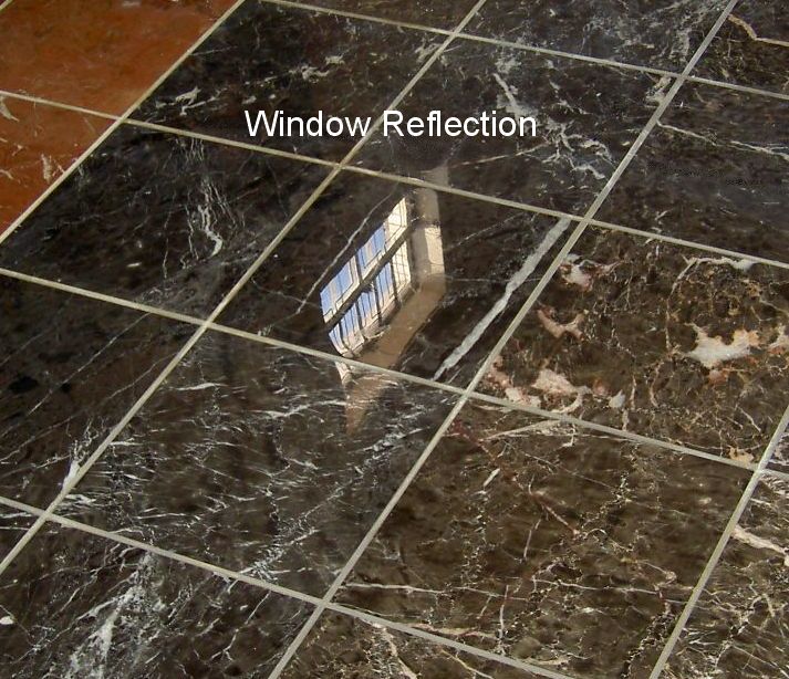

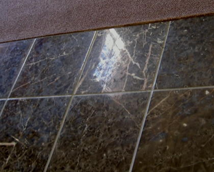

Here is one picture on some black emperador marble showing reflection detail of our showroom window about 15 feet above:
After Polishing, check out clarity.
Same Window Before Polishing

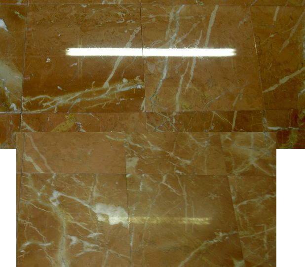

Another Marble - Fluor. Light After & Before Polishing

So what did you think of them Larry?. I know you sell powders and maybe you'll be carrying these as well but can you tell us your opinion?.
How did the floor look prior to the MP.

Albert;
It has no acid component like the polishing powders have.
No worry about surrounding stone or stainless surfaces.
I added some more marble photos.
I have a stone tech comparing the powder polish to the Monkey Pads.
