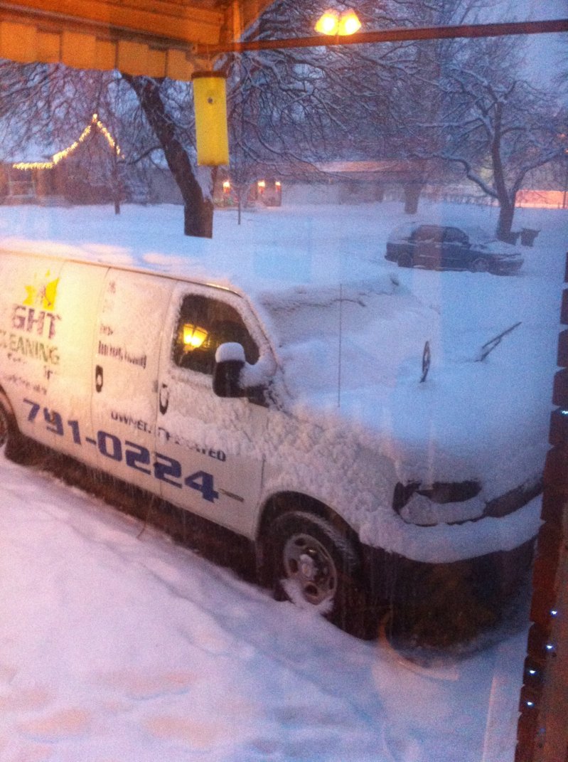

I wish I had the picture of my van in the driveway with about a foot snow on it that melted and froze all the doors shut in about two inches of ice.
It got parked inside after that.

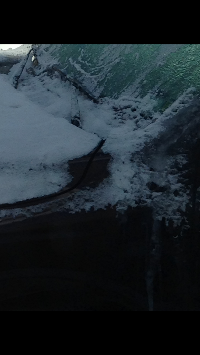

My 1st house I insulated the garage and didnt have to plug in a heater until it was less than 10 degrees out. This past wintewr was the first with parking outside and will be the last. Pluggin in the heater melted roof top snow then as the water flowed down the side - it froze the doors and wiper arms. There was like 2-3in of ice around the arm that had to be chipped daily along with chipping the door cracks to avoid bending the metal.
