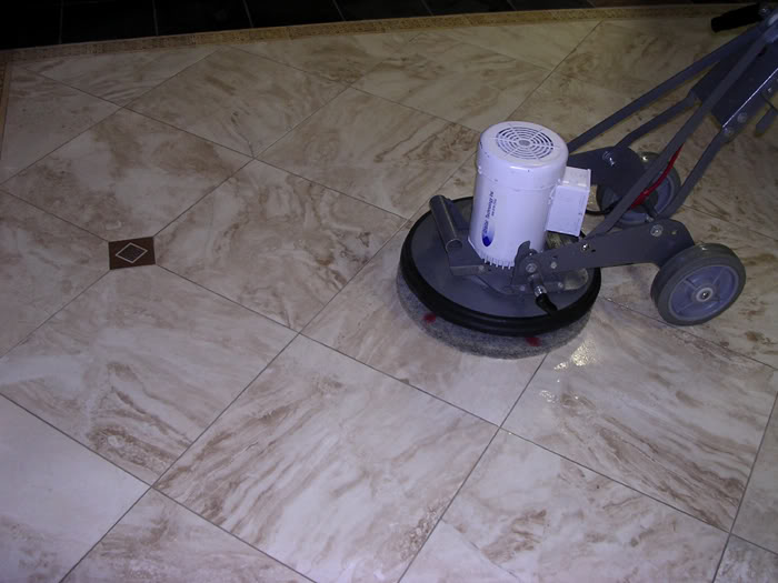

Ron, here's my impressions of the MP.
The floor was a limestone 16" squares with small tiles every 3-4". Don't know what the small tiles were made of but they were manmade. Floor was fairly shinny but had scratches from minute to fairly deep as well as a couple of deep etches.
We started with the 400 grit mp's then went through the set which were 5 other grits starting at 800 - 11,000.
Alot of the smaller scratches were taken out but some were still visible (seen while color sealing). The deeper etching was taken out with a hand machine (makita) using 200 and 400 grit diamonds. Mike used the op with the training wheels with the mps. I thought if we had some weight to it there may have been an improvement.
Ron, I saw your rotary that you used when you posted your pics. It had weights. Not too mention, it looks like that is a stone machine so initial weight is more then a standard one, is that right?. Maybe that one would have produced better results. Even the conqueror may have been better due to it being heavier. The 200 grit mp would have also taken out a bit more of the scratches and etching but Mike didn't have any.

Maybe one of the gurus can ID it.

dunno the floor....
but I agree alot with what albert said...and that was from my viewing them at the show...
also I would bet that a rotary would have done better then the op...
hey how many sqft and how long did it take???
