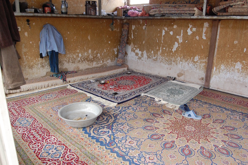

A few rug 'tech' photos. Taken at a rug finishing workshop in the Isfahan bazaar.
Local production carpet tacked out on a 'block floor'.

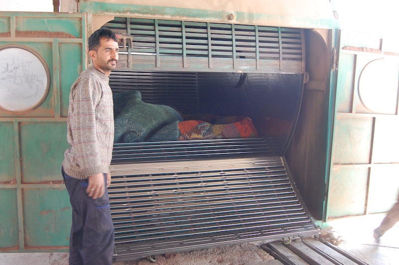

More photos from Iran.
At the Zollanvari wash house in Tehran. A closed facility that washes and finishes their proprietary production for export. Rugs come directly from the loom to this facility and leave ready for sale. They torch the backs, do a chlorination wash, shear, fix, stretch, and inventory the goods. It's an impressive operation that currently processes about 50,000 square feet of goods a month, though their capacity is easily twice that.
A really big tumbler. All rugs get dusted prior to washing.

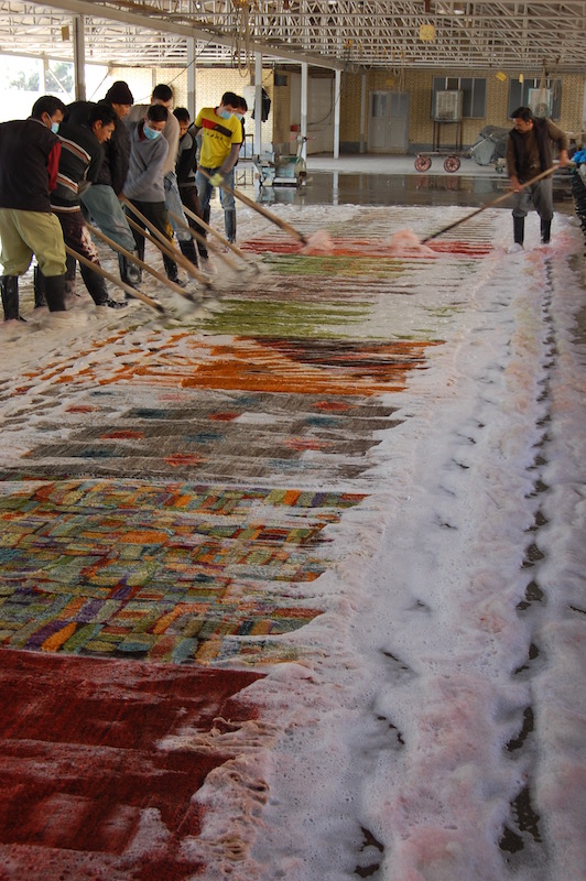

The wash crew - Afghan refugees living in Iran - uses steel bladed scrapers to work the wash formula into the pile.
They use a common laundry powder. Turns out 'barf' means snow in Persian.
